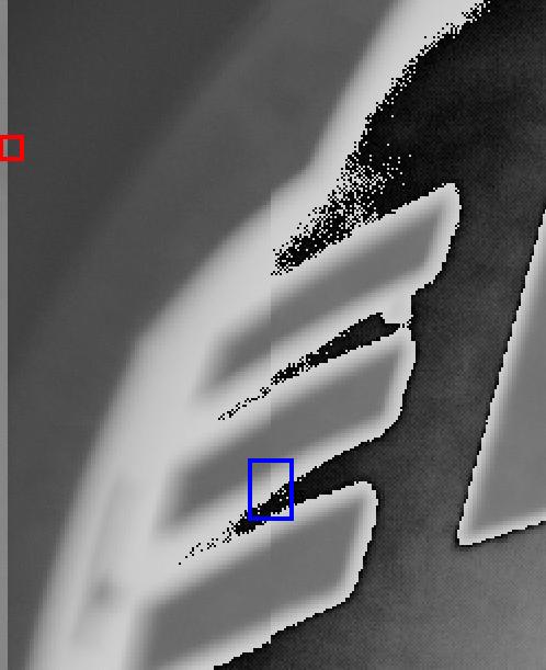

    Now I can see the image in the graphic view! But some think is happening…
    Follow just a little part of image. The entire image is 1024x720.
    In the red part, the 4 first columns is like the (around of) columns 160 of the image.
    I don’t know if because this happen the break of image in the blue part.
    Do you know why this is happen, and how can I fix it?
  • I don't use Graphic view, so I don't have good idea.
    But the image looks compressed. Did you compress the data for posting?
    Also, I see first 7columns are different and (I believe) it isn't related to the gap in column 160.
    I think this is Raw data, right?
    Did you take out blank data properly? So you write the image area only to memory?
    I don't have any clue about the gap in column 160, but is this the only gap you see in 1024 columns?
    Sang-Yong
  • Yes, I compressed the image and I just put a part of image.
    And there are first 4 columns different.
    It is a raw data, and I just write into ddr.
    I did some tests here setting the sensor with different resolutions, and I saw that first 4 columns copy different positions…. For example, in the VGA resolution, they copy around of column 160, in the XGA resolution they copy around of column 900….. it is very strange….
    That part of image than is break (or gap), in the all resolution break in the same potion. (Between 123 to 124 column).
    Some idea?

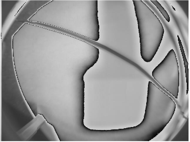

    This image is VGA (640x480).
    In this image, the first 4 columns are equal, around of, column 255, and the gap appear between column 123 and 124.
  • I am sorry for unclear request, but I asked Raw data itself, instead of viewer output.
    Also it might be helpful, if you capture recognizable scene.
    By the way, the column number of gap is always same if you fix image size?
    Sang-Yong
  • The raw data do you mean the data than I read of sensor and write into ddr? How can I share the raw data??
     And yes, the column number of gap always the same independent the sensor configuration (size and resolution).
