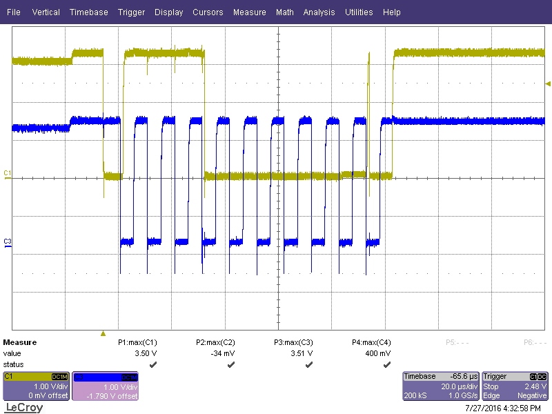

Dear All,
My team found that the use of AB18/AE18 for I2C1 (select from Pin Mux Tool) could only generate the 1st byte (slave address) with ACK (Low) from Device, no further clock and data for conmunication.
When we reworked to use G20/E25 for I2C1, the same configuration (OS,Driver,etc) resulted the I2C device read/write passed.
My team want to know whether AB18/AE18 could be configured as normal I2C Bus (I2C1) or any special cofiguration is required.
Arc Chen
I2C1 (SCL/AB18, SDA/AE18) waveform with only 1st byte:
    There are no restrictions for pins AB18/AE18. Check that your pinmux settings do not get accidentaly overwritten on these pins by another driver.
  • Hi Biser,
    Here is the run-time status for AB18/AE18 register:
         root@am437x-evm:/# devmem2 0x44e10a08
         /dev/mem opened.
         Memory mapped at address 0xb6fba000.
         Read at address 0x44E10A08 (0xb6fbaa08): 0x00050003 <= AE18
         root@am437x-evm:/# devmem2 0x44e10a0c
         /dev/mem opened.
         Memory mapped at address 0xb6f3a000.
         Read at address 0x44E10A0C (0xb6f3aa0c): 0x00050003 <= AB18
    Accrounding to TRM, last 4-bits should be pin function select.
    Mode 3 of AB18/AE18 should be I2C1 SCL/SDA, I think overwritten should not happen right here.

  • Is this a custom board or the AM437x GP EVM?
  • Hi Biser,
    This result is on customer's board.
    They use 3 I2C buses for application, I2C0 and I2C2 is working fine.
    During the debuging, they find out the issue on AB18/AE18.
    Is there any other thing we can check next?
    Attachment is customer's device tree setting.
    Thank you and Regards,
    Wayne Kuo

  • I have escalated this. Sorry for the delay.
  • Wayne, just curious if the same IO voltage rail is being used for the I2C device power rails.
    When using pins AB18/AE18, these IOs are powered by VDDSHV2.
    When using G20/E25, these IOs are powered by VDDSHV3.
    What type of I2C device are you communicating with, and what are its power rails connected to?  How are VDDSHV3 and VDDSHV2 powered?
    James
  • AM437x_Power_Page.pdfDear James,
    This is Arc, USI engineer from Shanghai.
    Refer to the power page of AM437x used on our board, both VDDSHV2 and VDDSHV3 are connected to 3.3V Power Rail.
    The I2C bus connected to one I2C Switch named as PCA9546A and EEPROM (M24256-BWMN6TP) on I2C Bus 0.
  • Hi Arc, what is the RESET to PCA9546A connected to, and is that being properly driven by AM437x during the I2C1 commands?  Are the address signals on PCA9546A pulled hi/low, or are they controlled by GPIOs as well?
    It seems to me that the AM437x is sending out the 1st command properly, but the I2C Switch is not ack-ing the command.  It is as if the I2C switch doesn't recognize the command or is in a state that is not allowing it to respond.
    james

  • Yes, that looks fine. Is VDDSHV2 configured as 1.8V or 3.3V? Can you post a picture from an oscilloscope demonstrating the issue?
  • All VDDSHV are at 3.3V. Oscilloscope picture: See Arc Chen's picture above, it looks identical. Transfer stops one bit AFTER ACK. It does not make a difference if an existing or non-existing device is addressed (ACK can be high or low). Therefore I suspect that the I2C-master does not see the ACK. How could that be?
