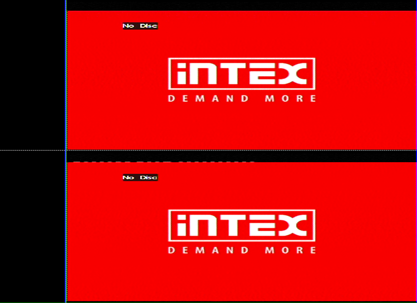

I am getting 2 interlaced field while capturing from adv7180 decoder, interfaced with vina port of sitara am5728 processor.
Fig 1.: Input image

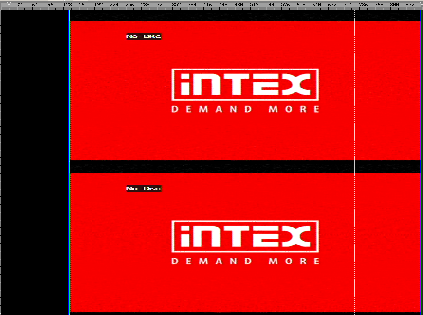

I am using VPE (vpetestm2m ) for de-interlacing and expecting 1 complete frame as output but the output  frame is same as input.
fig 2. output image
can anyone please tell me what is wrong ?
I am running vpetestm2m lke this
./vpetestm2m input.yuv 864 624 yuy2 output.yuv 864 624 yuy2 1 3

    since you have two frames in the input file you need to pass src-height equal to the half of the input image height (it is the height of the each of two frames). The test based on input format, frame width and height and filesize calculates how many frames are in input file.

    Please use capturevpedisplay application for capture - deinterlace - display usecase.
    As said before, for DEI, you need to:-
    - Request interlaced capture from VIP
    - Pass field size in the S_FMT (as per v4l2 standard)
    - Set the FIELD_ALTERNATE in the VPE source (V4L2_TYPE_OUTPUT) S_FMT ioctl
    You will find all of this being done in the capturevpedisplay application.

  • Hi Yordan & Nikhil,
    This is Single frame of size (864*624*2) but showing two different fields (864*624 each). Our requirement is to get complete interlaced frame without two separate fields i thought  VPE can do it but i feel  i misunderstood it. Can you suggest how can i get complete interlaced frame without two seperate fields. Earlier in dm8148 processor  we have done the same thing by changing in HDvpss firmware.

  • Hi Abhishek,
    What do you mean by "Our requirement is to get complete interlaced frame without two separate fields"
    Do you mean deinterlaced frame? Or Progressive frame?
    This is exactly what VPE does, converting interlaced fields into progressive (deinterlacing)
    After processing by VPE, you shall have 864 * 1248 as the size of output frame.
    BTW, the size of the field doesn't look right, is this really a field?
    Nikhil D
  • Hi Nikhil,
                 1. 864x624 is the size of complete frame which having 2 identical fields of 864x324 size each (hope it is clear now). So according to you the the input of VPE should be a field only (in my case should be 864x324 ) ? and it will give progressive frame of size 864x624 correct?
    2. Yes we want progressive frame.
