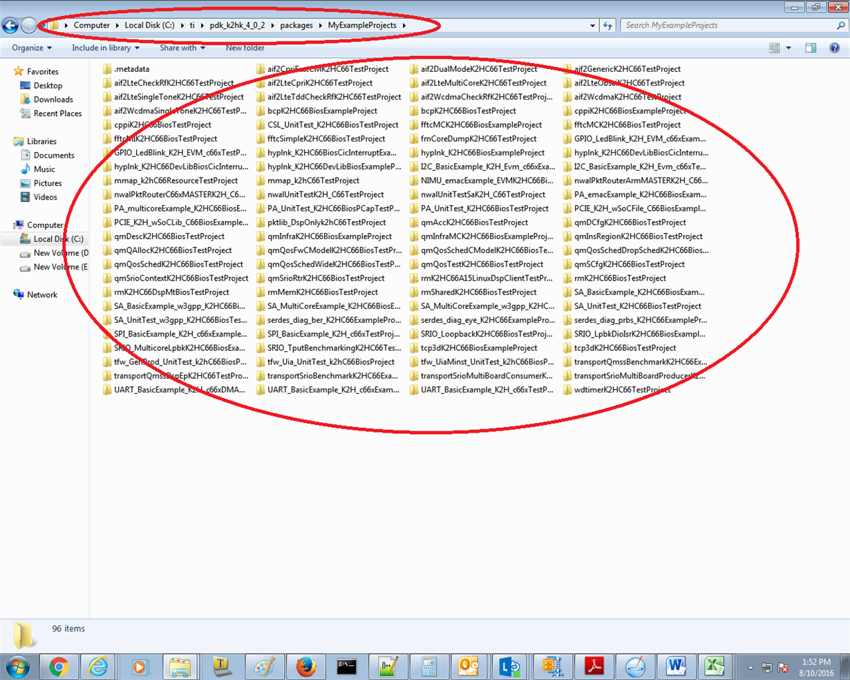

  • Can you create an example project for:
    TCI6630+OpenMP
    Where is the example for this scenario? if there is one
    Also I want to use JESD interface, where is the example for :
    JESD+TCI6630
    It seems that there is no example ready for these situations while there are not enough information for that, not given by TI
  • After you install the "ti-processor-sdk-rtos-k2l-evm-03.00.00.04-Linux-x86-Install_2.bin", you will get the "pdk_k2l_4_0_2".
    You have to use the scripts in it to generate the examples like below.
    The step by step instructions for generating the examples are given here.
    Using the above link I have generated the examples for K2H . Similarly you will get these many examples for the K2L too.
