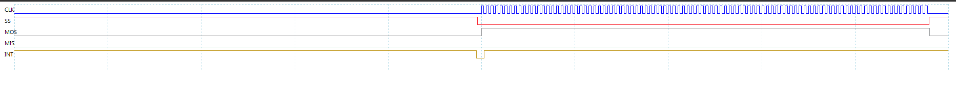

Hi all,
I'm trying to implement an SPI communication between the CC1310 and another microcontroller, and using the CS pin in the CC1310 the communication doesn't work, but if do not use the CS pin it works fine.
The CC1310 is configured with the following settings:

 This is a screen shot of what happens when the master send out the clock.
The SPI transfer in the cc1310 is being done before generate the interrupt pulse( is the INT signal showed in the screen shot)
SPI_transfer(spiHandle, &spiTransaction);
// Send Interrupt to the Host
fnStartIntPulse();
