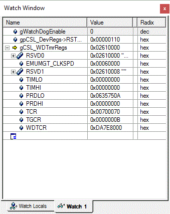

C6472 WDOUT not toggling
I'm configured timer3 to act as a watchdog and when I inspect the register WDTCR, the WDFLAG is set i.e. However the WDOUT pin is not being asserted low.
volatile CSL_TmrRegsOvly  gCSL_WDTmrRegs;	//declare WatchDog timer register
#define WATCHDOG_PERIOD 	1000 //msec
void WatchDogInit(void) {
	gCSL_WDTmrRegs               = (CSL_TmrRegsOvly) CSL_TMR_3_REGS;
	gCSL_WDTmrRegs->EMUMGT_CLKSPD= CSL_TMR_EMUMGT_CLKSPD_RESETVAL;
	gCSL_WDTmrRegs->TIMLO        = CSL_TMR_TIMLO_RESETVAL;
    gCSL_WDTmrRegs->TIMHI        = CSL_TMR_TIMHI_RESETVAL;
    gCSL_WDTmrRegs->PRDLO        = CSL_TMR_PRDLO_RESETVAL;
    gCSL_WDTmrRegs->PRDHI        = CSL_TMR_PRDHI_RESETVAL;
    gCSL_WDTmrRegs->TCR          = CSL_TMR_TCR_RESETVAL;
    gCSL_WDTmrRegs->TGCR         = CSL_TMR_TGCR_RESETVAL;
    gCSL_WDTmrRegs->WDTCR        = CSL_TMR_WDTCR_WDFLAG_MASK;	//clear

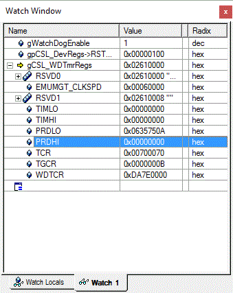

  • Khaled,
    What is the EVTSTAT value in RSTMUX3 register ? This should be 1 when you configure a timer in watchdog mode and timeout occurs.
    Senthil
  • Senthil,
    configured a global variable to point to #define CSL_DEV_REGS  (0x02A80000u) and checked the RSTMUX3.
    it starts with a value of 0x00000100 and when the watchdog triggers I get 0x00000110 (see snap shot below).
    But I don't see the pulse on WDout pin.
    Khaled.

    Adding the timer Hi did not change the behavior. In all cases, I was under the impress that for 64bits timers, the Hi registers are not used.
    Here is the dump of relevent timer registers before and after the watchdog has triggered.
    Khaled.
  • From the register dump, it appears that the Enable LO and ENABLE HI field in TCR are being set to 0x3 which is reserved as far as I can tell. The TGCR settings seems ok.
    Another key point is the WDEN bit in the WDTCR register is not set. This is the bit that connects watchdog timer output pin to the watchdog
    timeout event
    Rahul
  • Rahul,
    No error on the TCR = 0x00700070  ==> PWID_LO = 3; ENAMODE_LO = 1 PWID_HI = 3; ENAMODE_HI = 1
    On the WDTCR I'm enabling the WDEN bit (see command below).
        gCSL_WDTmrRegs->WDTCR =  ((CSL_TMR_WDTCR_WDEN_ENABLE << CSL_TMR_WDTCR_WDEN_SHIFT ) |
                                  (CSL_TMR_WDTCR_WDKEY_CMD1  << CSL_TMR_WDTCR_WDKEY_SHIFT));
                                  (CSL_TMR_WDTCR_WDKEY_CMD2  << CSL_TMR_WDTCR_WDKEY_SHIFT));
    I traced the WDEN bit error to CCS:
    If I run the code just after a hardware reset or after a power cycle, I get WDTCR = 0xDA7E4000 (see attached image).
    If the watchdog triggers I get WDTC = x0DA7E8000.
    If I re-run the code from CCS (Debug Halt, then Debug start), WDTCR = 0xDA&E0000.
    But in BOTH cases, If I run the code after a power cycle or if I re-run the code after debug/Restart, I get the SAME behavior i.e. WDout don't toggle.
    Khaled.
  •  Rahul,
    forgot to attach the WD registers dump if I run the code after a hardware reset or a power cycle.
    Khaled.
