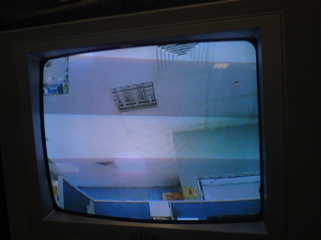

  • Hi, Anshuman,
    For the TV output NTSC, there is flickering at some place on screen and quality is not so gd . Is there any registers to tweak ? Please enlighten me.
    Eric

  • Hi Steve,
    Below is the TV output after doing resize and encode to 720x480 from a 640x480 YUV422 camera. The display is in YUV420SP.
    From the picture,you can see some smudging and jagged edges on the windows.  What can be done to reduce the smudging and jagged edges.
    BR,
    Eric
  • Eric,
    Unfortunately I am not an ISP/software expert so can't comment too much.
    I will try to get an expert to comment.
    BR,
    Steve
  • Did you use x1.125 in VPBE?
    > Horizontal x1.5 (3/2)/x1.125 (9/8) Rescaling Filter
    Sang-Yong
  • Hi, Sang Yong,
    I use the resizer to resize the VGA to 704x480, send to video encoder  to encode to H2.64 and send out using RTP.
    This is the video data received by the video decoder and display on the TV.
    I think I used the default settings in the driver. Where do I set the Rescaling filter you mentioned ?
    Eric

  • hi,
    I have already showed TV out with original code. And I also modified the function: davinci_enc_set_ntsc by my owned function as below:
    static void davinci_enc_set_ntsc_dout(struct vid_enc_mode_info *mode_info)
    /* set VPSS clock */
    davinci_writel(0x18, SYS_VPSS_CLKCTL);
    /* VPBE PINMUX */
    unsigned int temp = 0;
    void __iomem *pinmux1 = (void __iomem *) IO_ADDRESS(0x01C40004);
    temp = __raw_readl(pinmux1);  //select VCLKL and HVSYNC
    temp &= ~(0x01 << 22); //VCLK Enable
    __raw_writel(temp, pinmux1);
    printk("Ev NTSC out, GPIO PINMUX1 Set Value: 0x%08X\n", temp);
    //YCC8 BT.656
    dispc_reg_out(VENC_CLKCTL, 0x11);
    //OSD Set
    davinci_writel(mode_info->left_margin,
      (DM365_OSD_REG_BASE + OSD_BASEPX));
    davinci_writel(mode_info->upper_margin,
      (DM365_OSD_REG_BASE + OSD_BASEPY));
    dispc_reg_out(VENC_VIDCTL, 0x6000);
    dispc_reg_out(VENC_DCLKCTL, 0x005);
    dispc_reg_out(VENC_DCLKPTN0, 0x13);
    davinci_enc_set_display_timing(mode_info);
    dispc_reg_out(VENC_SYNCCTL, (VENC_SYNCCTL_SYEV | VENC_SYNCCTL_SYEH | VENC_SYNCCTL_HPL | VENC_SYNCCTL_VPL));
    dispc_reg_out(VENC_VMOD, 0x1001);
    dispc_reg_out(VENC_YCCCTL, 0x13);
    /* test color bar */
    //dispc_reg_out(VENC_VDPRO, 0x00);
    //dispc_reg_out(VENC_VDPRO, (0x01 << 8));
    After this modification I just can get the Video from VPBE but not TV out as before :)
    I really don't know what problem is. I need both VPBE and TV out video.
    Please show me how I am wrong.
    Thank you very much.
    Can someone give me a hint, suggestion or some ideas here?
    thanks
