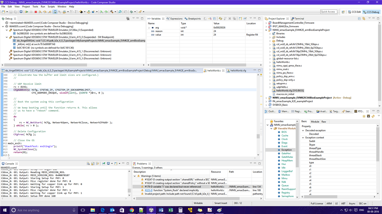

When i try to test PDK example delivered for K2E "NIMU_emacExample_EVMK2E_armBiosExampleProject" ,  The project results in SYSBIOS exit if Ethernet link is connected. Since this is a out of the box solution for along with PDK for K2E, i can't able to find solution for this issue after a long time trials.
I was using K2EVM with 66AKe05 processor device for running the example code. Is it a n issue someone observed or any evm settings is required for running this project?
Kindly help me to resolve or make some comments on this issue as support is required to move forward.

    Is that master core need to be 1?
    I was working on ARM core of 66AKE05 , and i think its a slave core. The exit is occurring at
    rc = NC_NetStart( hCfg, NetworkOpen, NetworkClose, NetworkIPAddr );
    line. Its a dataabort exception too.
    Hope it helps.
  • Screenshot shows Project View, stack view @ error happened. It ends at function do_AngelSWI from kill function
  • Yes, its known issue.
    We are working on this, I let you know once its fixed.

  • Dear Shino Samuel,
    I have got response from Dev team.
    For the exception errors that you are seeing are related to an insufficient NS_BootTask stack size. This change will need to be made in C:\ti\ndk_2_24_03_35\packages\ti\ndk\netctrl\netctrl.c around line 197. Change to:
    TaskCreate( NS_BootTask, "ConfigBoot", OS_TASKPRINORM, 4096,
    (UINT32)hCfg, 0, 0 );
    We have to rebuild the NDK package with this change.
    I am also trying to rebuild the NDK and update you.
    I was able to rebuild the NDK with this change, and the issue i reported was resolved.

    This same application logic works perfectly for DSP core in static and DHCP client mode.
    Debug Output:
    [arm_A15_0] QMSS successfully initialized
    CPPI successfully initialized
    PA successfully initialized
    TCP/IP Stack 'Hello World!' Application
    StackTest: using dhcp
    Service Status: DHCPC : Enabled : : 000
    Service Status: DHCPC : Enabled : Running : 000
    Any clue on this?
