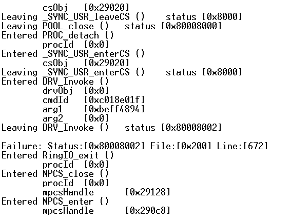

problem on usage of DSPLINK
I am using dsplink_linux_1_65_00_02 on SEED DEC138, which is a evaluation board of OMAP L138.
After the configuration and building, the samples finally run successfully.
The problem is:
after I run one sample, I can not run another sample without rebooting the board.
but I could run a sample repeatly without rebooting.
I can not figure out this problem. any suggestion would be very helpful.
  • Ni,
    This problem is not seen with the standard OMAP L138 board. All samples work one after the other.
    Can you tell me about the difference between the SEED board and the standard board? Also can you send the log to tell the exact error on second run?
    Deepali
  • I do not know what the difference between the SEED DEC138 board and the standard OMAP L138 board. I gues there are no distingush ones.
    I  turned trace on, and noticed that there was a failure in a running which was thought to be all right for the program returned to the shell after quiting normally.
    the LOG is as below.

    Entered DSPLINK_atExitHandler ()
    IMPORTANT: There may be several error prints in the atExit handler.
               These occur because DSPLink tries to clean up resources.
               If resources are already freed, it will cause errors.
               THESE ERRORS CAN BE SAFELY IGNORED.
    Entered MSGQ_transportClose ()
     procId [0x0]
    Leaving MSGQ_transportClose ()  status [0x80008002]
    Entered PROC_stop ()
     procId [0x0]
    Failure: Status:[0x80008002] File:[0x200] Line:[1168]
    Leaving PROC_stop ()  status [0x80008002]
    Entered POOL_close ()
     poolId [0x0]
    Leaving POOL_close ()  status [0x80008000]

    when I ran the sample 'loop' after I ran 'message', the program could not quit well, and did not return to shell.
    It stoped as the LOG below.
