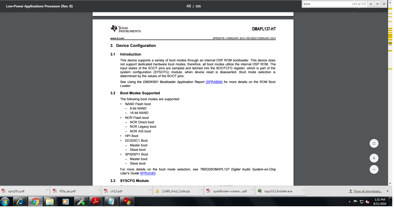

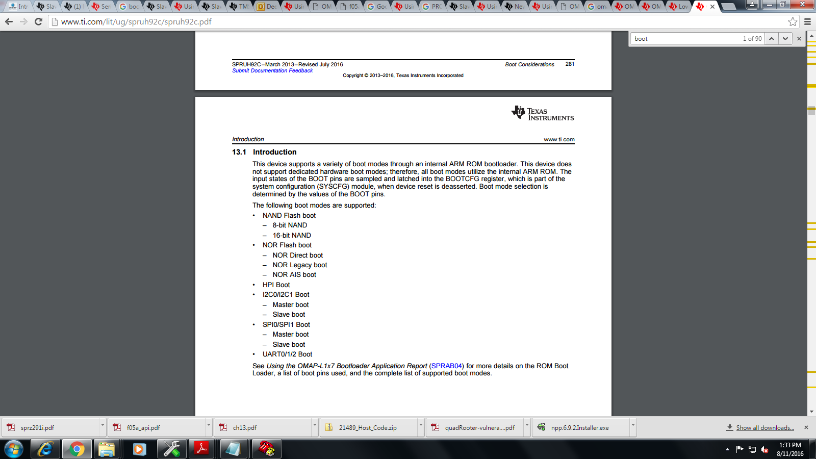

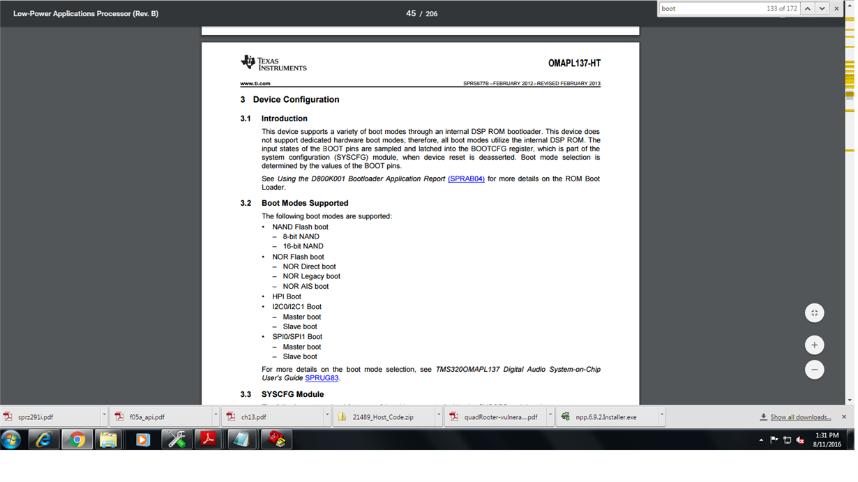

We are using the data sheet that is specified for omapl137
The following is the conflict
omapl137-ht.pdf
spruh92c.pdf
I have attached the images for reference
The following section IN DOCUMENT says the boot loader is taken from DSP ROM and ARM ROM
I have already a question regarding SLAVE BOOT spi0,
The OMAP we are using is OMAPL137BPTPH VERSION
I kindly request your team to respond on booting issue and clarify weather its booted from ARM or DSP BOOTLOADER and Refer an aprroach that should be followed w.r.t to booting the device from spi slave0

  • Dear Deepak,
    OMAPL137 is DSP boot master device where as OMAPL138 is ARM boot master.
    In OMAPL137, DSP comes out from sleep after released the RESET and in OMAPL138 ARM comes out from sleep first then DSP.
    If you want to run any ARM application on OMAPL137 then you need to use DSP UBL code to wake the ARM core and run on it.
    In same way, you need to use ARM UBL to wakeup the DSP and run the DSP app on OMAPL138 device.
    You can run DSP app directly on OMAPL137 and ARM app on OMAPL138.
    If you want to do slave boot in OMAPL137 then code should run on DSP core (need to develop code with DSP).
    Please let me know if any understanding issue on this.
