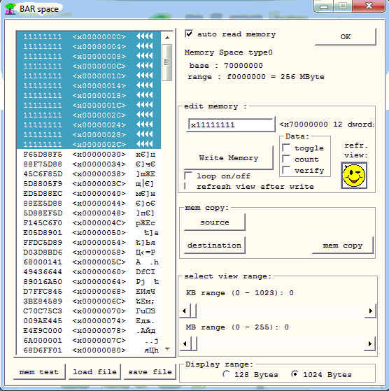

I'm trying to run PCIE_evmc6678_wSoCFile_C66BiosExampleProject on my evm6678le board inserted in PC. Program goes in bebug mode to moment of waiting receiving data from RC and receives nothing (I evaluate dstBuf variable, there are all elements null). I have no RC board and that is why I'm writing to 0x70000000 PCIe base address of EP evm6678le board 1 K of data (all words were 0x11111111) by software on PC(PCITree) but I can't see that data recieves in dstBuf variable . Also I've modified Example program on evm6678 and I've scanned range 0x00000000 - 0xFFFFFFFF of internal board adresses for my data (0x11111111) and it shows that there are no such data in board memory. Why can't I receive anything?

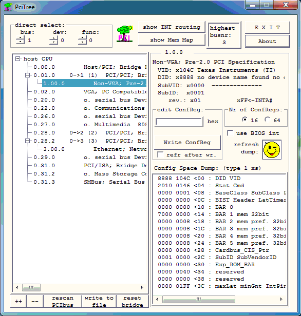

  • Program on PC are able to read all BARs 0 to 5, device ID, etc and able to modify memory of board through BAR1 memspace. But PC didn't modifed base addresses in BARs maybe because of I've programmed board only after PC boot.

  • Here is evm6678 in PC hierarchy
    I've programmed board after booting PC and I think BAR0-5 have to stay with no changes after launching PCIe_BIOS_example on it...
    In window below I can write or read any quantity of data through different adresses. I've tryed one adress write transaction and 40 words (dstBuf length in example) and some other quantities of words to write at one click. And while debugging PCIE_example on board in CSS I've examined contents of dstBuf and all adresses in c6678 0x00000000 - 0xffffffff. I've seen that dstBuf had no changes and there was no writen data in board memspace...

  • From your screenshoots,
    - BAR0-5 was programed by DSP program, your RC didn't change it, BAR 1 = 0x7000_0000 looks good

  • It's strange... I can write some adresses with base 0x7000_0000 and then I can read by PCITree program what I've wrote but 0x1086_c100 all zeros... Maybe there are another EP in my PC with 0x7000_0000 base address? Or could it be that for some reason I 've written data in some hidden hardware buffer in PCIe peripheral in evm6678?
