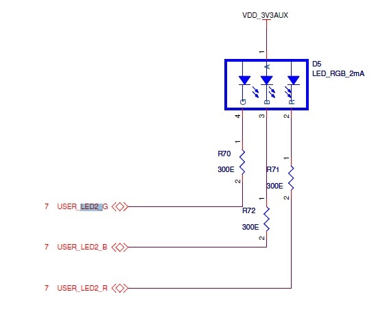

2) We connected the leds in common anode mode to the processor as shown below
So when the processor enters into standby mode, led gpios are configured to pulldown, which makes the LED to glow at standby mode. To override this, I have added pinmux control for sleep in device tree as follow,

But still the leds are on, when the processor enters into standby mode. Whether by default it will only configure the gpio as pulldown...?
    Can you try configuring the led_gpio_sleep as ( PIN_OUTPUT_PULLDOWN | MUX_MODE7 ) & led_gpio_default as ( PIN_INPUT_PULLUP | MUX_MODE7 )? Do you get the leds to stop glowing when device is in standby?

    For leds, I tried the configuration you mentioned, but still LED is glowing when I enter into standby mode. I tried with led_gpio_sleep as ( PIN_OUTPUT_PULLUP | MUX_MODE7 ), but led gpio pins are always low, during standby mode which makes led to glow.
    Since Led pins by default goes to pulldown on standby, I'm having doubt on SDIO pins sleep mode configuration( but I didnt configure sleep pin configuration for Wifi SDIO pins), which may prevent SDIO interrupt.
    So how to override this standby mode pin configuration..?

  • Hi Manoj,
    What is the voltage level you get out of the gpio pins, when you set them high? Is it equal to the 3V3, which you use to power the leds?
    I've made a mistake, you need to drive the pins high in sleep state, if you want to get the diodes to stop golwing.. so on sleep you should try with PIN_INPUT_PULLUP or just PIN_INPUT  (without any pulls)... sorry for the confusion.

  • Hi Yordan
    When the processor goes suspend mode, the led class driver (drivers/leds/led-class.c) always make the particular gpio to low logic. Below is the code which cause suspend in led driver.
    void led_classdev_suspend(struct led_classdev *led_cdev)
    led_cdev->flags |= LED_SUSPENDED;
    led_cdev->brightness_set(led_cdev, 0);
    EXPORT_SYMBOL_GPL(led_classdev_suspend);
    I changed the code into led_cdev->brightness_set(led_cdev, 1), then my problem got solved. Is it correct the way..?
    Manoj
  • Hi Manoj,
    Yes, I missed that part of the needed kernel modifications... Yes, by inverting the logic, you will have the leds turned off, every time the device goes to suspend.
