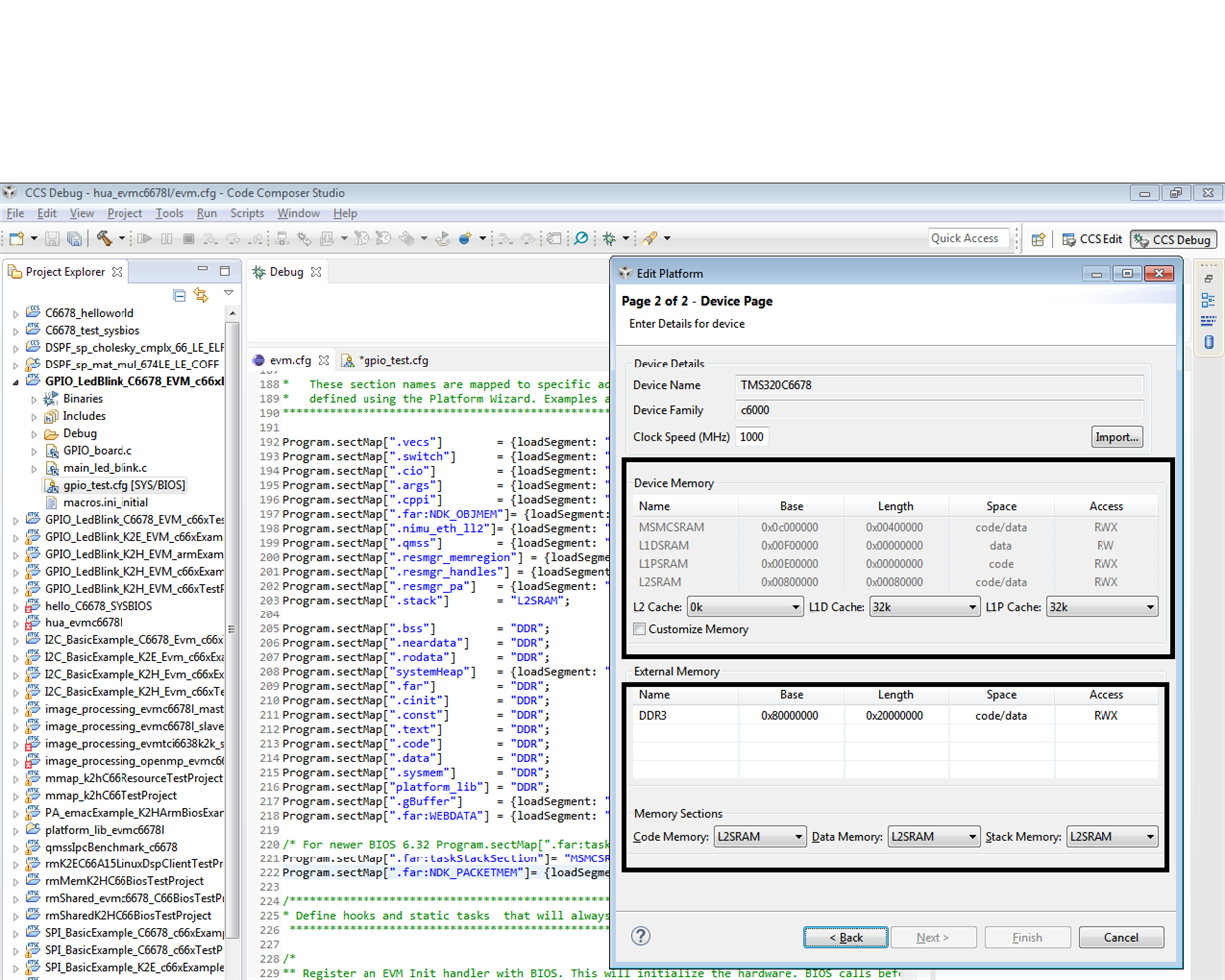

How can I move the section to some other memory like DDR in *.cfg file?
Other Parts Discussed in Thread: TCI6638K2K
Hello.
I faced some problem to use heap memory.
Actually, I already asked to this TI community and I received replay that recommended to move the section to some other memory like DDR, SRAM in *.cfg file.
But I don't know how I can move the section to other memroy by modifing *.cfg file. Please tell me the way to move the section ot other memory.
The previous question is like below.
Please help me. Thank you.
Hello. I got a problem and I hope to get some advice from TI community.
My device is TCI6638K2K and it has eight TMS320C66x DSP cores.
I am implementing some program and I already increased heap size as 16384 by modifing app.cfg files to use few thread.
And yesterday I added library file to my project and I faced problem that is memory lack related.
The compile error is like below.
How can I add library file without any compile errors.
Please help me.

"configPkg/linker.cmd", line 136: error #10099-D: program will not fit into available memory.  placement with alignment fails for section ".cinit" size 0x15a9 .  Available memory ranges:
   L2SRAM       size: 0x100000     unused: 0x1238       max hole: 0x1200
error #10010: errors encountered during linking; "asn_1_3rd_edsoed.out" not built

  • Just like this in your *.cfg.
    Program.sectMap[".cinit"] = "DDR3";
    This will put .cinit section on memory named DDR3 in your platform.
    Naoki
  • Hi Gyeongho,
    The memory is not available to fit your program. So, in the *.cfg file you can make modification to map the memory segments into other memories such as DDR/MSMCSRAM or you can try editing the length of the Device-memories.
    As Naoki said, you can use the other device memory for memory segments such as  .cinit/.const/.text/.code and try using it.
    When you would like to change the memory name, origin and length of "DDR" or "L2SRAM" or "MSMCSRAM",
    Go to Tools-->RTSC Tools --> Platform --> Edit / View --> select "C:\ti\bios_6_45_01_29\packages", select the
    appropriate package name and then, you wil get a platform edit screen like below:
