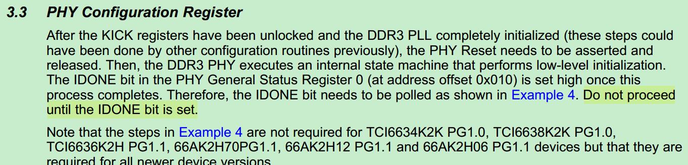

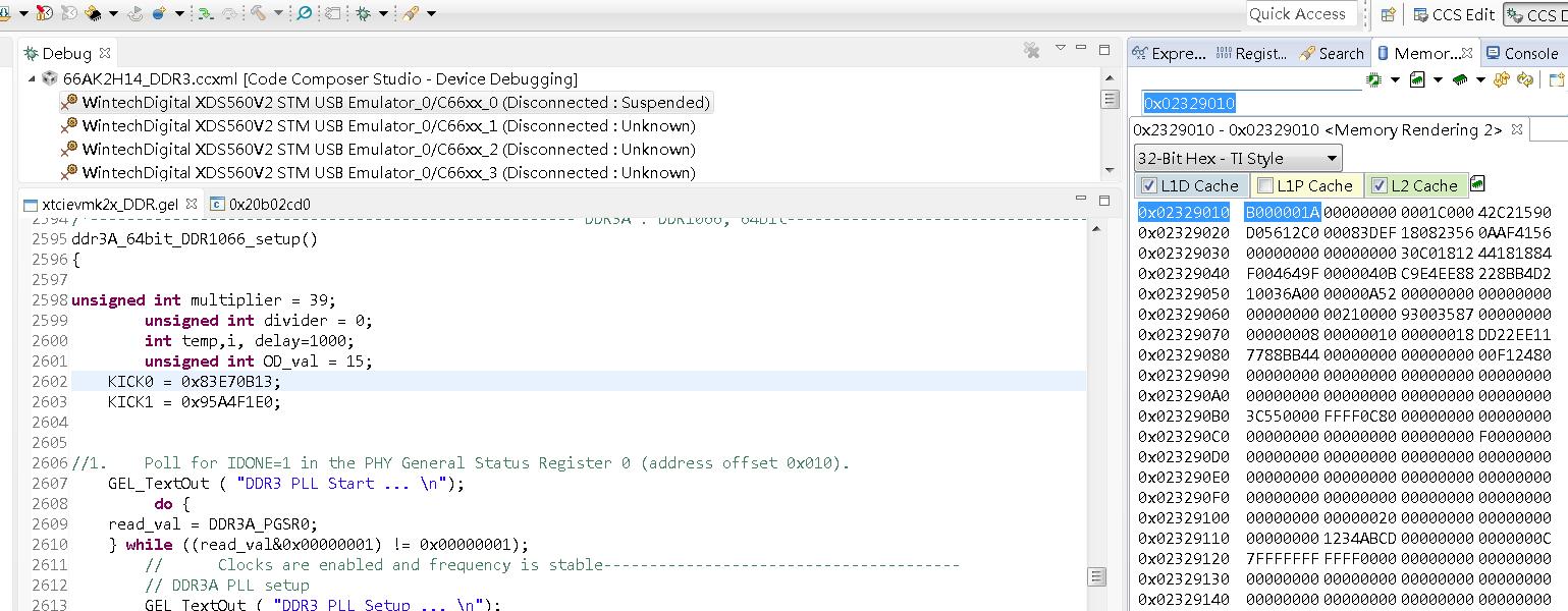

When I load the GEL with version 'TCI6638K2K GEL file Ver is 1.60000002' xtcievmk2x_DDR.gel
I find that the function ddr3A_64bit_DDR1066_setup has be stuck at here
do {
    read_val = DDR3A_PGSR0;
} while ((read_val&0x00000001) != 0x00000001);
And a registers snippet is showed as
What's the problem?
