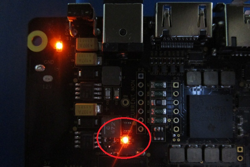

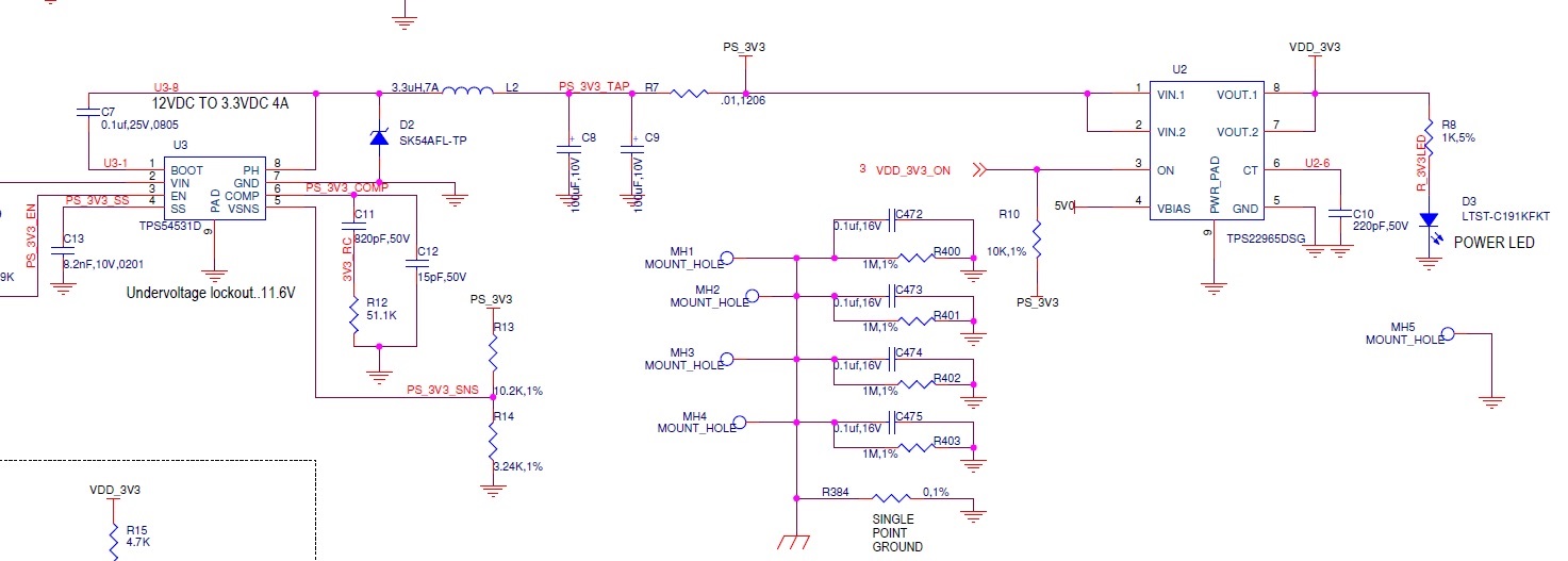

When inserted boot SD card, push the power button then light LED D3 and board boot up.
When removed the SD card, push the power button also light D3, but D3 turned off after a while. why?

If there is no boot image that takes control over the PMIC, after a certain time it stops the power to the AM572x SoC.
If you want to overcome this, you should populate J5, or in the older revisions of AM572x GP EVM, you should swap R23 with R28 .
