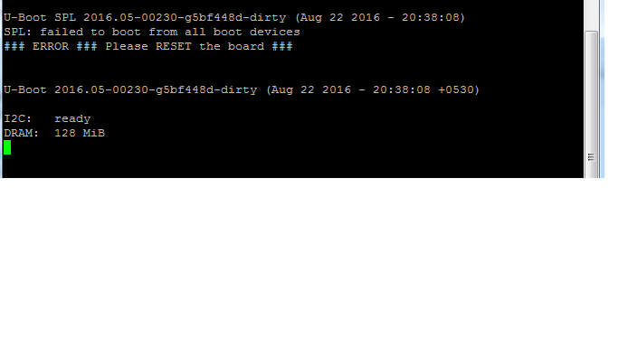

AM437x SPL/u-boot flasher image loading issue using CCS studio.
Hi All,
I am trying to load the U-boot flasher images (SPL and U-boot) using the CCS studio with the help of JTAG interface on to our custom board based on AM437x.
After loading the SPL and U-boot images onto the custom target, u-boot execution was halted as shown in the attached image and not proceeding further.
Did any one see this kind of issues?
Please help me what could be the issue and how can I resolve this issue on our custom platform.

    Did you configure your memory correctly? See this wiki for details: processors.wiki.ti.com/.../AM437x_DDR_Configuration_and_Programming_Guide

    2806.AM43xx_EMIFconfig_HWlvl.gelHi Biser,
    thanks for the response .. Yes we believe we have done the right configuration. Just to give the background we are using the same DDR3 part that is being used in the EVM, however we have connected only the 13 lines. Attaching the schematics for your reference (please ignore the part number).   Also we are using the attached gel file for the DDR3 configuration. The DDR3 Integrity test  passes with the values used however we see the hang when loading the second stage bootloader. Also attaching the console logs with more debug prints.
    Please review the schematic/the configuration values used are fine and why this issue could happen.
    Siva

  • Hi Siva,
    Those are bit fields in the EMIF4D_EXT_PHY_CTRL_x (x = 1 to 36). Thy are described in Section 9.3.4.94 through Section Section 9.3.4.165 of AM437x device data manual.
    Also the wiki link, provided by Biser, explains how to set these registers:
    You can see the values of these registers defined in board/ti/am43xx/board.c , search for "ext_phy_ctrl" in the file.
    As for the GEL settings, I see that your gel file is similar to the original AM43xx_EMIFconfig_HWlvl.gel, with the exception that you operate in narrow mode (16-bit) only:
    WR_MEM_32(EMIF_SDRAM_CONFIG_EXT,0x2C163); => you set EMIF_SDRAM_CONFIG_EXT[17]NARROW_ONLY = 0x1
    and you have added a delay
    for (i=0; i<1000; i++) ;
    to ensure the hw initialization completion.
    The narrow_only setting is OK if it matches your hw. As for the initialization try setting a lower delay, maybe just call an empty function, i.e.:

  • Team,
    The DDR integrety tests fail at the later addresses of the DDR. Attchaching the test result. Could you please provide some pointers on possible reasons of failure.
    Shiv

    CortexA9: GEL Output: Starting DDR3 configuration...
    CortexA9: Output: EMIF PRCM is in progress .......
    CortexA9: Output: EMIF PRCM Done
    CortexA9: GEL Output: EMIF CLK enabled...
    CortexA9: GEL Output: Waiting for VTP Ready .......
    CortexA9: GEL Output: VTP is Ready!
    CortexA9: GEL Output: VTP controller enabled
    CortexA9: GEL Output: Checking if DLL is ready...
    CortexA9: GEL Output: DLL is ready
    CortexA9: GEL Output: Configuring DDR IOs and Control Module registers...
    CortexA9: GEL Output: Configuration of Control Module registers complete
    CortexA9: GEL Output: Setting up DDR3 H/W leveling configuration...
    CortexA9: GEL Output: Starting EMIF controller configuration...
    CortexA9: GEL Output: EVM==2
    DDR3 Hardware leveling complete... Outputing all the leveling results !!!
    CortexA9: GEL Output: PHY_STATUS_12=0x0700003C
    CortexA9: GEL Output: PHY_STATUS_13=0x07000037
    CortexA9: GEL Output: PHY_STATUS_14=0x07000700
    CortexA9: GEL Output: PHY_STATUS_15=0x07000700
    CortexA9: GEL Output: PHY_STATUS_16=0x00000000
    CortexA9: GEL Output: PHY_STATUS_7 =0x00000047
    CortexA9: GEL Output: PHY_STATUS_8 =0x00000047
    CortexA9: GEL Output: PHY_STATUS_9 =0x00000000
    CortexA9: GEL Output: PHY_STATUS_10=0x00000000
    CortexA9: GEL Output: PHY_STATUS_11=0x00000000
    CortexA9: GEL Output: PHY_STATUS_17=0x0019004B
    CortexA9: GEL Output: PHY_STATUS_18=0x01E5004D
    CortexA9: GEL Output: PHY_STATUS_19=0x0035039D
    CortexA9: GEL Output: PHY_STATUS_20=0x00500369
    CortexA9: GEL Output: PHY_STATUS_21=0x00000000
    CortexA9: GEL Output: PHY_STATUS_22=0x03D9000B
    CortexA9: GEL Output: PHY_STATUS_23=0x01A5000D
    CortexA9: GEL Output: PHY_STATUS_24=0x0035039D
    CortexA9: GEL Output: PHY_STATUS_25=0x00500369
    CortexA9: GEL Output: PHY_STATUS_26=0x00000000
    DDR3 configuration is complete!!!
    CortexA9: GEL Output: Turning on EDMA...
    CortexA9: GEL Output: EDMA is turned on...
    CortexA9: Output: ****  AM437x SK EVM Initialization is Done ******************

  • Shiv, a couple of questions:
    1. Earlier in the post, you said that the integrity test passed, but then later it failed. What changed between the two.
    2. Can you try with invert_clkout=1. Note you have to make 2 changes in the GEL for this. See section "Proper initialization for DDR3 H/W leveling" in the following wiki: processors.wiki.ti.com/.../AM437x_DDR_Configuration_and_Programming_Guide
    3. Once you have it stable thru JTAG in CCS, then make the appropriate changes in SPL and try it there. If it still doesn't boot, you can perform a register dump of the EMIF registers and compare with the working register dump from the GEL
    James
  • -------- Original Message --------
    From: "Nagalikar, Shivasharan" <
    shivasharan.nagalikar@ti.com>
    Date: Thu 15 Sep, 2016, 10:27 PM
    To: "Doublesin, James" <
    doublesin@ti.com>
    Subject: Fwd: Sitara Processors Forum: AM437x SPL/u-boot flasher image loading issue using CCS studio.
    James, not able to reply on e2e from mobile, sorry.. initially they checked only address 0x80000000 and some 500 locations only which was passing. Then they thought that DDR was done bit booting its failing. When I tried investing checked higher address locations and it's failing there. With invert clock 1 also I have tried. So nothing has changed between two only that they concluded without testing completely.
    Shiv
  • Shiv, the output of the GEL shows this line:
    Which means it will use
    #define IDK_EVM_DDR3_SDRAM_CONFIG     0x61A11B32  //32-bit DDR3
    I think you intended to use this SDRAM_CONFIG register definition
    #define DDR3_SDRAM_CONFIG       0x61A05232  //16-bit DDR3
    I would double check in CCS memory window what the SDRAM_CONFIG register is getting set to.  Based on the output of the memory test, I think all of your timing is setup correctly, but the DDR configuration is not correct (as dictated by SDRAM_CONFIG register)
    James
  • Hi James,
    Yes that value is also tried and it did not help.
    Shiv
    I also had the same problem with a similar processor. The U-Boot was running fine, when it was loaded from eMMC, but stopped at the same point when it was loaded with JTAG from CCS.
    The solution was to build U-Boot with CONFIG_SYS_DCACHE_OFF define enabled to disable using data cache.
    I guess you could get over it by now, but it might be helpful for someone having the same problem.
    David
