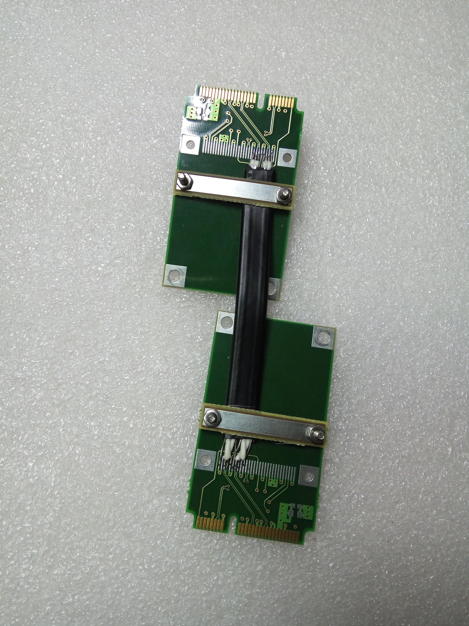

  • Host is a linux machine(PC). I use this connector to connect EP to RC. The clock is not connected. There are only tx/rx.  The Linux host and AM572x EVM has its own seperate clock.
    The host provide PCIe enumeration. It doesn't matter, what the link speed I use, but I use GEN1 for accuracy. The PCIe link is stable. The PCIe core in EVM AM572x doesn't generate an error interrupts during traffic.

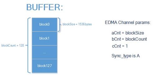

    On AM572x side I am running on A15. A buffer consists of a blocks. In the EDMA channel params aCnt is block size, bCnt is block count in a buffer. I send a first block of a buffers one by one, and other blocks send in the EDMA Channel TCC CallBack function by call the EDMA3_DRV_enableTransfer function with trig_mode_manual.

    If I use 4 channels with blockSize(bCnt) = 1536, it is broken too. But if I use 4 channels with blockSize = 2048 it is not broken.
    If I use 8 channels it always broken, while I not allign OB Region addrs to 1M. Numbers of broken buffers is random. Only first part of buffer breaks.
