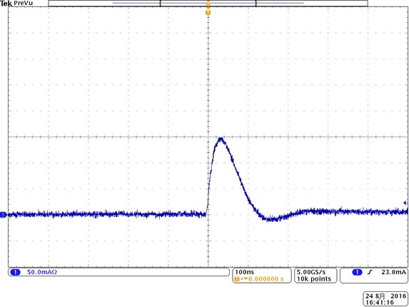

By noise measures, our customer added a condenser (4,700pF) to the line of the touch panel, but an inrush current in this way becomes about 150mA/100nsec.
With the data sheet of AM335x, the drive current of the TSC ADC lists it with up to 25mA.
TSC ADC pin flows through about 150mA/100nsec by an inrush current, will there be a problem?
The following inrush current is input.

  • This peak current is not compliant to the specification and has not been characterized. Please ask the customer to insert a small value resistor, about 27 ohms, between each AIN pin and the capacitor. Hopefully this will reduce the inrush current to an acceptable level without degrading touch screen performance.

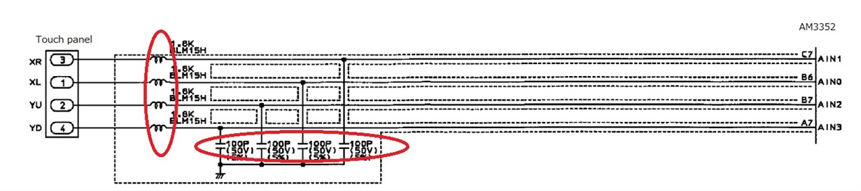

  • I would like to confirm how they connected the 4700pf capacitor to reduce noise.
    I assume they connected one terminal of a 4700pf capacitor to each AIN pin connected to the resistive touch screen. The other terminal of each capacitor is connected to ground, and they are positioned near the AIN pin. Is this correct?
    If so, these capacitors will shunt any noise coupled into the touchscreen and associated signals to ground.
    When the touch screen controller provides power to the resistive planes, the capacitors would need to be charged. This produces a large inrush current because there is nothing to limit the current. The peak current would be reduced by inserted 27 ohm resistors between the AIN pins and capacitors since the series resistor limits inrush current required to charge the capacitor.
    Assuming the capacitors are still connected to the touch screen signals near the AIN pins, they would still shunt any noise to ground. The series resistors should not have any effect on noise immunity. However, they would reduce the inrush current.
    Paul

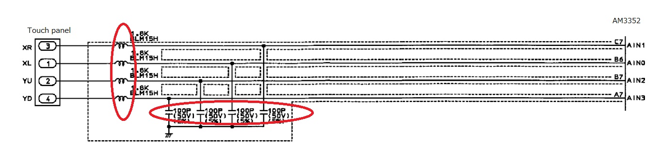

  • Hi Paul,
    Thank you for quick reply.
    Our customer seems to be connected like the following figure.
    Even if this inductor changes it to the resistance, there is no effect.
    According to your answer, must our customer attach resistance between AIN pin and capacitor?
    In the case of this workaround, it is told that there is not it because a circuit change is necessary from our customer.
    Is there other workaround?
    Shigehiro Tsuda
  • As mentioned previously, they should insert 27 ohm resistors between the capacitors and the AIN terminals. Inserting them between the capacitors and touch screen will not reduce the inrush current.
    Paul
  • I'm not aware of any way to keep the shunt capacitance on the touch screen signals and reduce the inrush current from the AIN terminals without changing the PCB design.
    Paul
