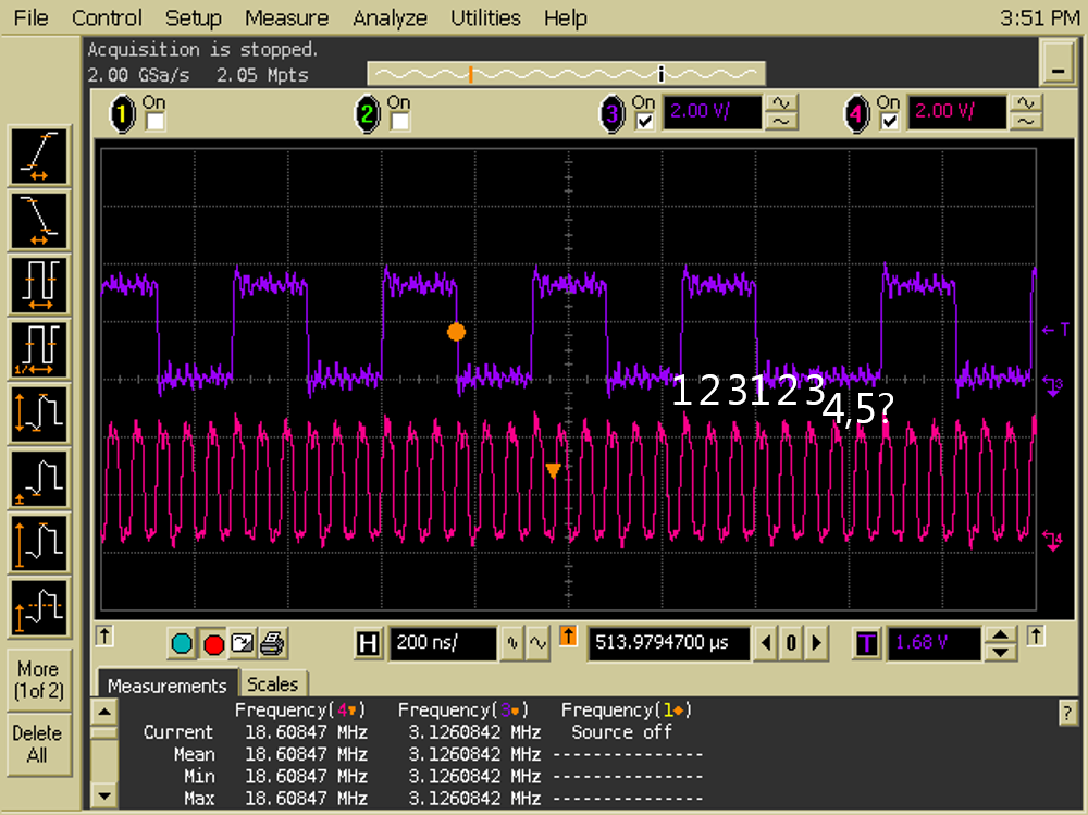

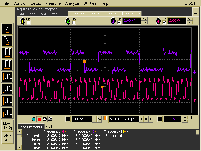

i want to use SDRAM via EDMA
but i think something has been wrong
After Writing 8 Cycle, there is a two idle cycle(EMIF CLK)
i want to eliminate the idle cycle
what should i do?
look at attached image please,
Channel 3  is one bit of data of sdram, and Channel 4 is the EMIF_CLK

    To follow what is happening on an SDRAM EMIF, the traces needed are CEn, RASn, CASn, WEn, although the names may vary from one device to another.
    The EDMA will have a burst size that it can handle in a single command to the memory bus. This will be described in the EDMA User Guide for your device. The memory bus will also have a maximum that it can handle which may be described in the EMIF UG. In some cases these can be modified under program control to make them larger.
    The DMA operation programmed by the PARAM or other means, depending on your device, will establish a transfer size. This can also affect the memory command sent to the EMIF.
    The width of your memory bus on the EMIF is also important to know for this.
    It will also depend on the nature of the DMA commands to determine the bursting or overlapping of SDRAM commands.

    Which TI device are you using?
    >> I'm using TMS320C6747
    >> i'm using 16 bit of them
     Actually, i connected DAC(Digital to Analog Converter) through EMIFA
    So i don't need any Access Sequence
    if the Data written on every single rising edge, it will be enough for me
    I Modified the burst size of the EDMA Transfer Controller (from 16 byte to 64 byte)
    and now
    after writing 16 times, there are some idle cycle
    i think this phenomenon is about the data burst
    Could you help me more?
    Wanseung Yang
  • Wanseung Yang,
    The SDRAM interface was defined by the someone a long time ago to provide a powerful and flexible interface to memory devices. It is not intended for driving a fixed, continuous sequence like what you appear to desire for your DAC. There will be gaps at some points in time no matter what you do. You have managed to minimize those gaps, but if your design is not tolerant of periodic gaps then you will need to do something differently.
    The asynchronous memory interface is not as fast as the SDRAM but it is more predictable and should be able to support a consistently repetitive sequence of data writes to a DAC. The highest possible data rate is EMIFCLK/3, and it might be slower than that depending on board and system constraints.
    The C6747 does not have a uPP Universal Parallel Port, but the C6748 does. The uPP was designed for working with streaming peripherals such as a DAC.
    You may wish to provide a complete description of what you require or intend for this design. But, there is no help beyond the advice above that I can offer at this point.

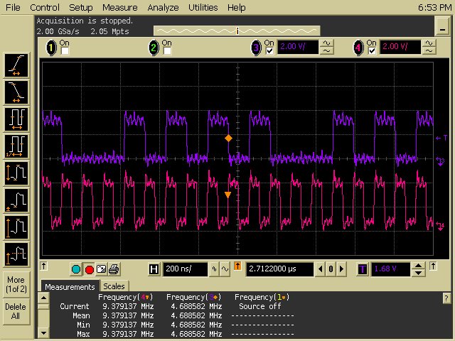

    i also tried Async Memory Interface
    you mentioned like below
    the 3 of EMIFCLK/3 means 1 cycle for Setup, 1 cycle for Strobe, 1 cycle for Hold Right?
    So i think a data should be written after every 3 clock
    sometimes but it need more clock than i expected
    please attached image
    Channel 3 is a bit fo the EMIF and Channel 4 is EMIF CLK

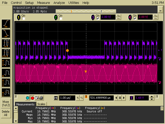

    and Also
    after writing about 2000 times there is a unexpected delay
    Please refer to the below Image

  • Wanseung Yang,
    I suspect the gaps you see using the asynchronous interface are due to either the SDRAM controller's refresh cycle or delays when the EDMA moves to a new transfer. But those are only guesses. My recollection is that SDCR.SR needs to be written to 1 to avoid the refresh even if SDRAM is not actively used. You could search the forum for SDCR to see, but I think I have discussed this on other EMIF's having a similar problem in the past.
    Both of these are correct. But there may be no guarantee that an extra cycle never slips in between the writes. The EMIF was not designed for that purpose.
