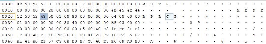

    I compile my project, get ELF. Then I convert ELF to RPRC by out2rprc.exe utility. Then MulticoreImageGen.exe composes multiple RPRCs into one "app" file (multicore image).
    So, file "app" contains a high-level multicore header and multiple RPRC images, each of which has its own header. RPRC image has multiple sections, which are loaded into memory independently.
    If section happens to be aligned on sector border (inside "app" file, not per destination memory address) then multiple block read is invoked and it doesn't seem to work. If section is not sector-aligned, then multiple block read is never invoked, regardless of the size of the section.
    Multicore header is sector-aligned (it is located at offset 0 in "app" file), but it is less than 512 bytes (sector size), so reading it does not invoke multiple block read either.

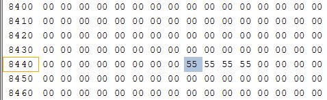

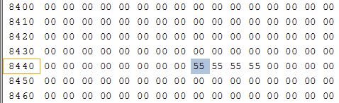

    I looked at your file and did the same thing in a file at my side. I used \pdk_am57xx_1_0_3\packages\ti\board\diag\uart\src\uart_diag.c, as I have a top level batch file to call the makefile to build the .out on A15, then rprc conversion, finally uses multicoregen to covert it. Note the output is called uart_TEST after this process, then I rename it to "app" to be loaded by MLO in a SD card.
    I also have data section a and b as you and adjust the section a size to make the section b aligned to 0x200 boundary. One thing I am not sure is 0x200 to what address?
    If you open the "app" by a binary viewer, starting at address 0x0 is the multicore image header, starting at 0x20 is the RPRC header, starting from 0x48 is the real image.
    So I used aa[187] or aa[195] or aa[205] to make it aligned to different offset. Below is a picture of the hex view of the app, and my last attempt to align 0x200 to the offset of 0x48 (real starting of the code). My data_b pattern is 55 55 55 55. In all of the 3 trials, I can't reproduce your issue, that is section b is loaded properly in my test.
    Can you explain in what kinds of 0x0200 align to see the issue? I also attached my source code for your info.

  • In your example marker has offset 0x8848. So, you need to shift the marker back to 0x8800 or forward to 0x8a00. Assuming that this binary was generated from source with aa[205], you want to change the length of array "aa" to either
    205 - 0x48/4 = 205 - 18 = 187
    or
    205 + (0x200-0x48) / 4 = 205 + 0x6e = 205 + 110 = 315.
    So, you should use 187 or 315, whichever you prefer.
    You said that for 187 you weren't able to reproduce the problem. If so, can you give me the binary ("app"), for which marker is sector-aligned and problem is not reproducible? I will try it here.
    By the way, better use debug build. For release build compiler does all kinds of optimizations and you have less control over the final binary. Anyway, if you manage to set the marker sector-aligned and section is still >= 1K, it should trigger the problem.
    I tried your example. I had to edit the source code, because it did not compile for me (different include paths, warnings as errors etc.). For me, aa[191] put the marker at 0xc200 (I use debug build).
    And, voila:
    Section .data_b loaded incorrectly
  • Sorry, I am blind. I have read your offset as 0x8848, while it is 0x8448. So, you want to shift it to either 0x8400 or 0x8600. But the numbers 187 and 315 still do apply.
  • John,
    offset 0x8400 was one of my test case. Attached is the .out file, .map file and app with number 187.  You can see the map:
    *(.data*)
    .data_a        0x8000652c      0x2ec /ti/PDK_AM~4/packages//ti/board/obj/idkAM571x/armv7/uart_diag.o
                   0x8000652c                aa
    .data_b        0x80006818      0x400 /ti/PDK_AM~4/packages//ti/board/obj/idkAM571x/armv7/uart_diag.o
                   0x80006818                bb
    Also, binary viewer showed marker at offset 0x8400. I didn't see any issue when app is loaded by MLO (the UART printed right info). I also connected JTAG to A15 core, and looked at memory address  0x80006818 to make sure it is the marker there.
    Regarding the compile issue you met when using my source code, I think you need to run the pdksetenv.bat first to setup you path and tool. Then run the gmake idkAM571x_sd under diag folder for this. Of course, this created many diagnostic images, but I just use setup for my convienece. I renamed uart_TEST into app to be loaded by MLO.
    I am not sure if you use AM571 or AM572, and what kinds of EVM. The app I sent you may not run properly on your card for UART print, but I think you can connect the JTAG to check the address of data_b to make sure it is loaded correctly into memory.
    Temp.zip
    Regards, Eric
  • In your "app" marker is sector-aligned now, but it does not start an RPRC section.
    My understanding is that each allocatable ELF section turns into RPRC section (I might be wrong).
    Here are the sections of your ELF file (uart_diagExample_idkAM571x_armv7.out):
    There are 23 section headers, starting at offset 0x5c67c:
    Section Headers:
     [Nr] Name              Type            Addr     Off    Size   ES Flg Lk Inf Al
     [ 0]                   NULL            00000000 000000 000000 00      0   0  0
     [ 1] .startcode        PROGBITS        80000000 016d4c 000000 00   W  0   0  1
     [ 2] .text             PROGBITS        80000000 010000 00652c 00  AX  0   0  8
     [ 3] .data             PROGBITS        8000652c 01652c 000820 00  WA  0   0  4
     [ 4] .bss              NOBITS          80006d4c 016d4c 000460 00  WA  0   0  4
     [ 5] .heap             NOBITS          800071ac 016d4c 001000 00  WA  0   0  1
     [ 6] .stack            NOBITS          800081ac 016d4c 010000 00  WA  0   0  1
     [ 7] BOARD_IO_DELAY_CO PROGBITS        40300000 008000 0003e8 00  AX  0   0  8
     [ 8] .ARM.exidx        ARM_EXIDX       403003e8 0083e8 000008 00  AL  2   0  4
     [ 9] BOARD_IO_DELAY_DA PROGBITS        403003f0 0083f0 00177c 00  WA  0   0  4
     [10] .debug_info       PROGBITS        00000000 016d4c 01f396 00      0   0  1
     [11] .debug_abbrev     PROGBITS        00000000 0360e2 002b04 00      0   0  1
     [12] .debug_loc        PROGBITS        00000000 038be6 009a4f 00      0   0  1
     [13] .debug_aranges    PROGBITS        00000000 042638 000a40 00      0   0  8
     [14] .debug_ranges     PROGBITS        00000000 043078 001218 00      0   0  1
     [15] .debug_line       PROGBITS        00000000 044290 007453 00      0   0  1
     [16] .debug_str        PROGBITS        00000000 04b6e3 00eda2 01  MS  0   0  1
     [17] .comment          PROGBITS        00000000 05a485 000070 01  MS  0   0  1
     [18] .ARM.attributes   ARM_ATTRIBUTES  00000000 05a4f5 000039 00      0   0  1
     [19] .debug_frame      PROGBITS        00000000 05a530 002054 00      0   0  4
     [20] .shstrtab         STRTAB          00000000 05c584 0000f6 00      0   0  1
     [21] .symtab           SYMTAB          00000000 05ca14 001d00 10     22 296  4
     [22] .strtab           STRTAB          00000000 05e714 000f87 00      0   0  1
    Key to Flags:
     W (write), A (alloc), X (execute), M (merge), S (strings)
     I (info), L (link order), G (group), T (TLS), E (exclude), x (unknown)
     O (extra OS processing required) o (OS specific), p (processor specific)
    There are no ".data_a" or ".data_b" sections. Only conventional sections ".text", ".data" and etc.
    The reason is your linker script, which merges all *(.data*) sections into one .data section of the output ELF. Your map file shows that:
    .data           0x8000652c      0x820
                   0x8000652c                . = ALIGN (0x4)
    *(.data*)
                   0x8000652c                aa
                   0x80006818                bb
    So, section ".data_b" in *.o file does not generate the section in ELF file and, therefore, RPRC section in "app".
    Proposed solutions:
    1. Rename ".data_a" and ".data_b" to something else, which does not match the pattern .data* from your linker script. But make sure it does not match any other pattern either. Your first goal would be to get two custom sections be present in ELF file, in this case they will turn into RPRC sections in app.
    2. Edit the linker script, for example, declare explicit output sections ".data_a" and ".data_b". Change the pattern for output ".data" from *(.data*) to *(.data.*).
    3. Try to make .data section sector-aligned. You will need to change the size ".text" section. You can do by writing dummy code or, (most probably) by adding const arrays (typically const data goes to .rodata section in object files and end up in .text section in ELF - but check your linker script). Also don't forget to place the marker in the very beginning of ".data" section - it starts with "aa" array per your map file.
  • John,
    I see. You need them into some seperate sections rather the .data to let the problem happening. As suggested, I created new sections in linker command file and padded code to make bb array 0x200 aligned. I reproduced the issue and will debug this with our development team. Thanks for the guide!
    Regards, Eric
  • The trigger condition is - RPRC section must be sector-aligned and >= 1K. It can be any section, including .data, .text or whatever. But it is easier to shift the start of custom section and place the marker in the beginning of it.
