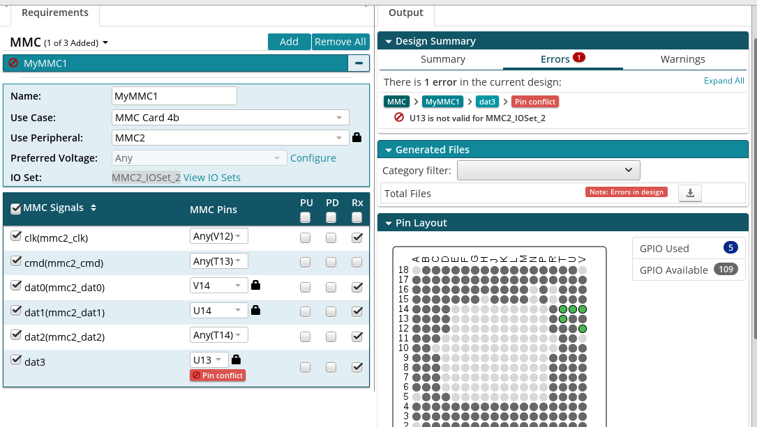

I am using an ZCZ AM335X CPU. I want to use TI's wifi chip WL1831 on the cpu's SDIO mmc_2 port.
To manage the pinmuxing I use the online pinmuxing tool provided by Ti (dev.ti.com/pinmux).
My board use V14, U14 and T14 for SDIO data 0 to 3 and U13 for sdio data 3 line, but this last pin causes a conflict:
If dat0 to 3 are not configured ( or with different pins) U13 is usable.
Is this an error coming from the online tool I can ignore? Or is there an other good reason to this that makes impossible to use these pins together?
