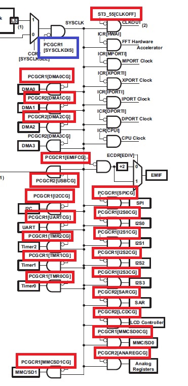

I have a question about IDLE of C5505
Expert 2780 points
Hi!
My customers to use the C5505, is under development.
When they have confirmed Idle, problems occurred.
C5505 will enter the power down in PCGCRx or PCGCRn and ICR + idle instruction.
In two cases, the difference of about 1.3mA when measured current has occurred. The reason for this difference?
Case 1. After setting the PCGCRn, it was stopped the set to clock the SYSCLKDIS.
Case 2. After setting the PCGCRn, without setting a SYSCLKDIS, stopped the clock in the ICR + Idle instruction.
*The difference forms in the case when the next order is executed and the case which isn't done.   /* System clock disabled */
 CSL_FINST(CSL_SYSCTRL_REGS->PCGCR1, SYS_PCGCR1_SYSCLKDIS, DISABLED);

In the figure below, to set the SYSCLKDIS, not difference of 1.3mA has occurred.
* CLKOUT was turned off, but an electric current didn't fall so much.

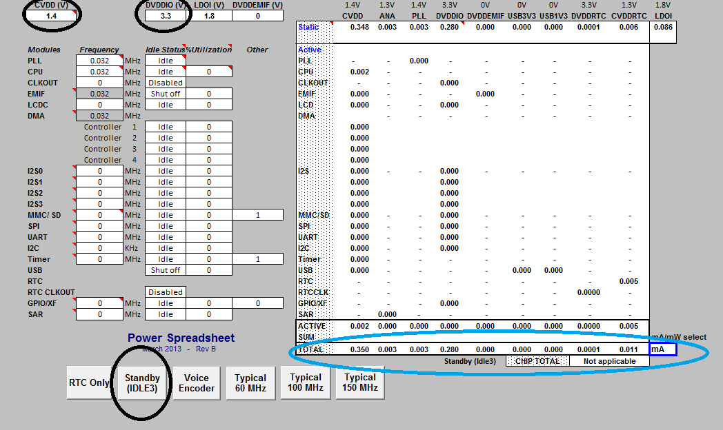

    Could you let us know the idle power number that you measured?  Did you compare your power numbers with power spread sheet ? It would be interesting to know if the data is aligned with power spreadsheet idle power data.

    CVdd = 1.4v / DVdd = 3.3v / LDOI = 1.8v /Standby mode = 1.59 mW
    0.47mA * 3.3v = 1.551 mW? ... same
    1.74mA * 3.3v = 5.742 mW? ... too many

    Thanks for providing the information.

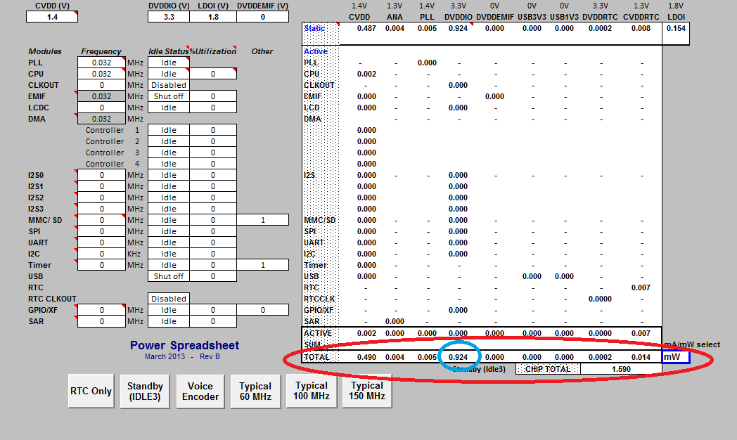

    The Idle3 current you are observing almost aligns with the power spreadsheet, which is ~0.6 mA, which is typical power number. Below is the snapshot for your reference.
    Your below power calculation looks not correct,
    For calculation of power in mW, you multiply Core voltage with core current , IO voltage with IO current ... and sum of all will result power in mW.
    Snapshot below depicts power in mW based on the above calculations.
    Hope this clarifies.

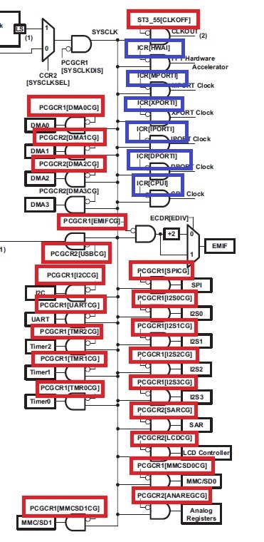

    By the difference besides the blue parts.
    Will it be such difference?
    Is there a part which isn't turned off yet?
    case 1
    case 2

  • PCR2 [DMA3CG] also has to OFF.
    To Clarify,
    In case1 since you switch of the System clock the clock frequency doesn’t matter. In case 2 your system clock is not disabled, but you are executing idle instruction,  that’s the reason I was checking with you on the source and frequency of the clock. Assuming the clock source is external clock and  frequency to be 12 MHz, then the current measured is ~1.3mA (2.50mW) as per the powerspreadsheet . If your case2 scenario is same as this then, what you are observing seems correct.
    With respect to your question “Is there a part which isn't turned off yet? - If you have taken care of disabling the clocks in PCGCR, then it should be correct, the clocks to respective peripherals would get disabled.

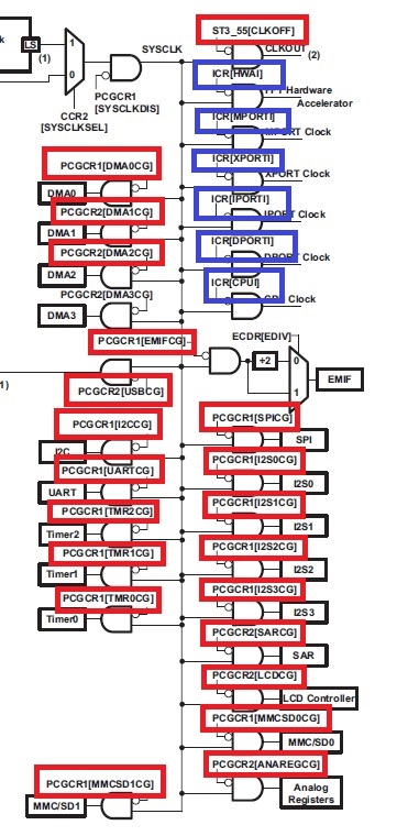

    (Because I heard a different reason ...)
    They want to know why there is a difference to the clock by comparing the case1 and case2 there is no block being supplied.
    In between the other of the gate from SYSCLKDIS in case2, much whether current is needed?
