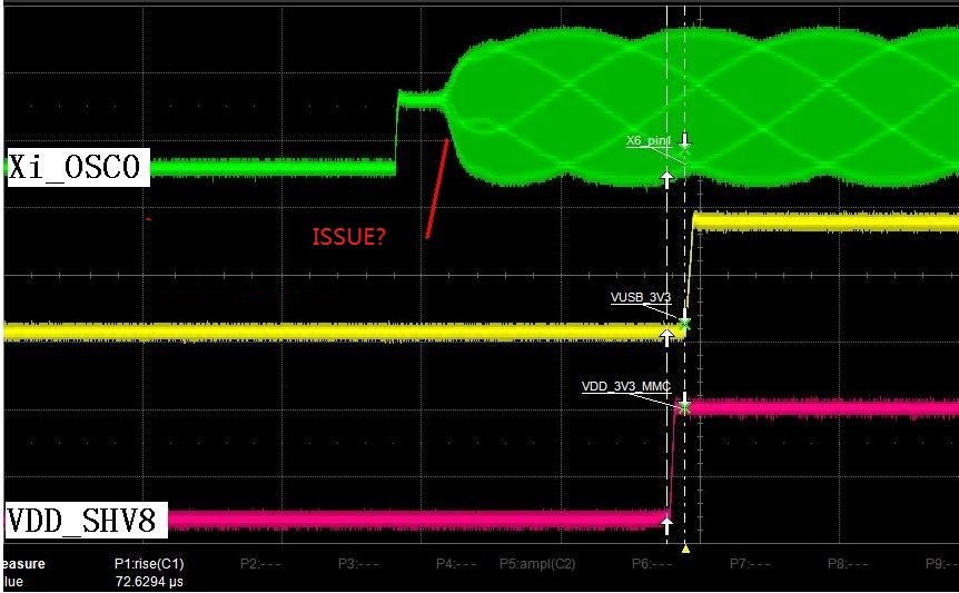

Dear Champion,
   My customer met one issue with power up sequencing between VDDSHV8 and OSC0.

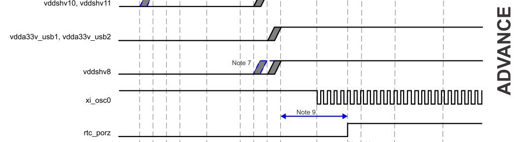

   As shown in the datasheet, the requirement is as below, it seems the OSC0 should after VDDSHV8 powering up.
However, this is the test result from the oscilloscope: the OSC is comming before VDDSHv8. Does this lead to a reliability issue?
