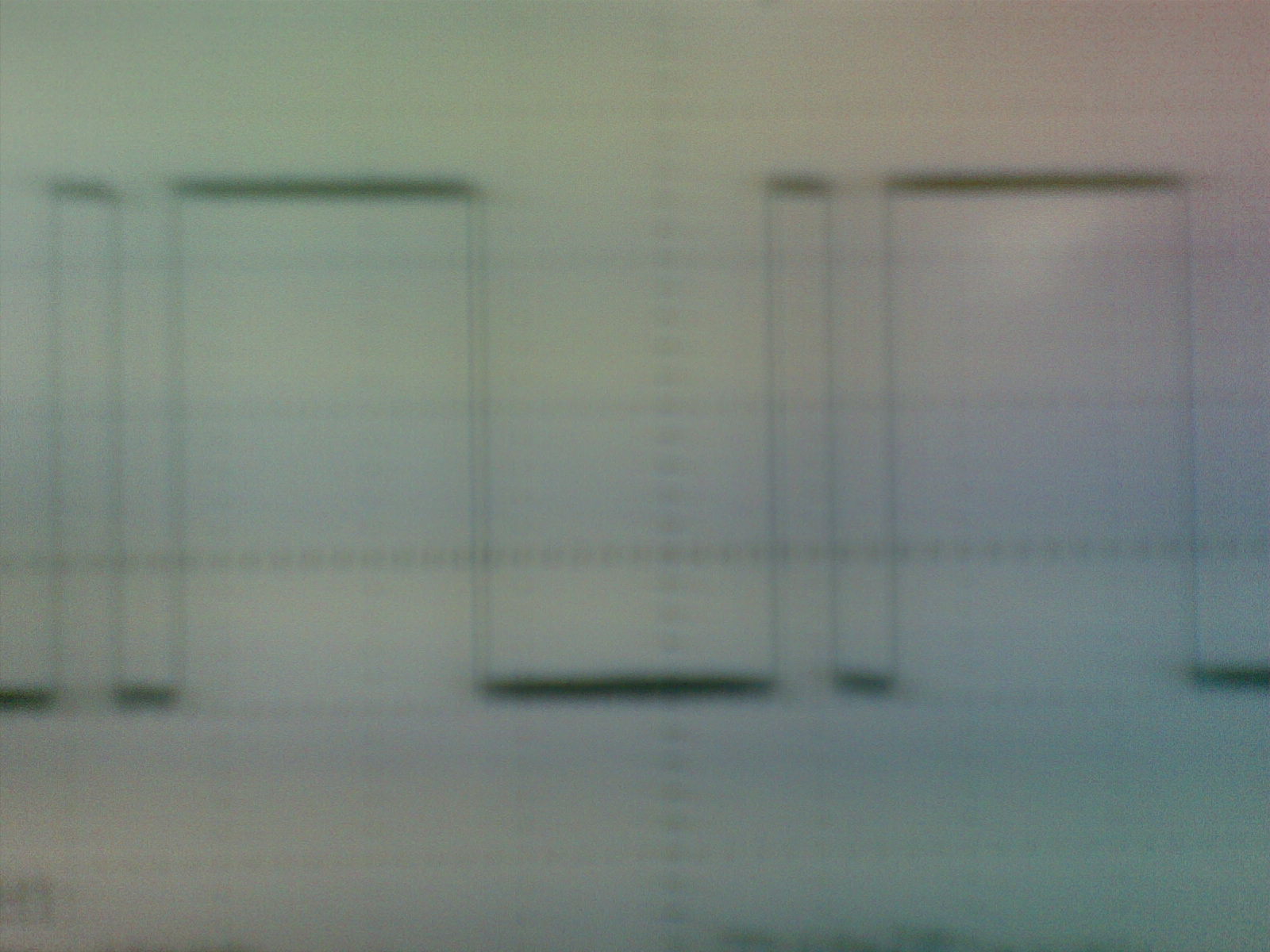

PROBLEM:
I can see the GPIO is changed every T period. However, I also find that the GPIO is shaking . That is to say , the moment GPIO is set the opposite value is different for each round (period T).(about several ns).Is it caused by the uncerntain time DSP corresponds to the timer interrupt?I don’t know why.oscilloscope, 1.From the
2.I want the GPIO is set at the same time for each period exactly. I don’t hope that in this round  the GPIO is set at NT+t0,the GPIO is set at NT+ t1 .Is there another method to achieve it?
  • I believe you are experiencing the variation in interrupt latency due to the DSP executing code when an interrupt occurs. This is also referred to as interrupt jitter, and it can vary much more than a few nanoseconds depending on what the DSP is doing.
    If the DSP is executing some single-cycle instructions in a sequence when the timer interrupt occurs, then the interrupt process will be very fast and the latency will be at a minimum. If the DSP has just started a multi-cycle instruction such as a B branch when the timer interrupt occurs, then the interrupt will be held off until that Branch instruction completes. If the DSP is executing an optimized software-pipelined sequence with branches looping into the sequence, then the interrupt could be held off for 100's or 1000's of CPU cycles.
    The C Compiler has a switch -mi to set the interrupt latency threshold. But this will be measured in instruction cycles and can still be very long for what you are looking for.
    If you can manage to put the DSP into an IDLE instruction every time it is going to receive the timer interrupt (instead of the while  (1); loop), the latency should be minimized and consistent. This would not be practical for most applications, though.
    The timer has a timer output, TOUT0 or TOUT1, that can be driven directly by the timer. Please refer to the Timer Reference Guide for information on the use of the timer output, and refer to the C6713 datasheet for information on how to configure the TOUT0/AXR0[2] pin to be used as a timer output. You can still have the timer interrupt, and could use that to change the timer period or count if you want to have a varying signal on the output pin. But if you want a simple square wave, then the TOUTn pin will meet your needs without any further DSP interaction.

  • TOUT is the "right" solution for generating a regular and accurate square wave or periodic pulse. It will not use CPU bandwidth.
    Method 1, if you manage to catch the timer at the value T, could have as much or more jitter than your original plan. If you do not catch the timer at the value T, then you will miss one or more pulses whenever that occurs, and that would be disastrous. A better way to do Method 1 would be to save the value of the timer each time you read it, then compare the current value with the previous value. If the previous value is smaller than the current value, then the timer past through 0 and was reloaded to T. But the jitter is still large and you are using the CPU to generate a square wave which is not a good use of a fine DSP.
    Method 2 should work. What is it doing wrong? It should be low jitter, but not a good use of a fine DSP.

  • Sorry for my mistake on the timer interrupt. I see in Section 7 of SPRU582B that the frequency of the interrupt will be the same as the frequency of TSTAT.
    Here are the three methods that would work:
    DSP polling of TSTAT:
    I do not like suggesting this one because I do not like putting the DSP into continuous polling mode, but since you were considering it originally I will include it as an option. When the timer interrupt occurs, it will load the latest PRD (call it T1) into the TIM and begin counting down again. In the ISR, you can write a new PRD value (call it T2) that will be loaded when the timer reaches 0 next. Now, start a DSP polling loop reading TSTAT until it changes at the end of the current output phase. When TSTAT changes, write another PRD value (T1 again), and the waveform should be what you are looking for without jitter.
    Two timers:
    Rather than using the polling loop to wait for TSTAT to change, you could use the second timer in the C6713 to generate an interrupt just after when TSTAT changes in the middle of the square wave. You can do this by setting PRD1=0xFFFFFFFF. In the Timer0 ISR (the one generating the output), set TIM1=PRD0 (or TIM0) and set PRD0=T2. Timer1 will generate an interrupt when TIM1 reaches 0, and this will also be when you wanted to get an interrupt from Timer0 but cannot because of the timer design. In the Timer1 ISR, set PRD0=T1 and either let Timer1 continue running from the large value loaded from PRD1 or stop Timer1 and re-start it in the Timer0 ISR.
    Phase Adjustment (my preferred choice):
    In the Timer ISR, read the current value of TIM. Assuming that PRD=T2 and that you want the current phase to last for T1, subtract (T2-T1) from the value of TIM and also subtract a correction factor to account for the number of timer ticks that occur during this code execution. Write the new value to TIM, and this phase of the timer output will be adjusted.
    Because of the frequency difference between the DSP and the timer, there could be some phase jitter introduced by this Phase Adjustment method. I can think of 2 ways to try to avoid that jitter:
    1. Stop the timer, read TIM, subtract (T2-T1-correction), write TIM, start the timer. The correction factor may need to be a little larger, but this should work.
    2. Add some asm(" NOP"); instructions to tune the DSP code to be exactly a multiple of timer ticks from reading TIM to writing TIM. This will have to be tuned experimentally because the cycle count has to include the internal delays for the write to reach the TIM register.
    Let me know if this makes up for my mistake.

  • hi,Randy!
    According to the request , I choose method 1 (DSP polling of TSTAT), and it works!  I 've got  a very beatiful waveform  of  which duty cycle can be changed . I really appreciate for your warmhearted help.
