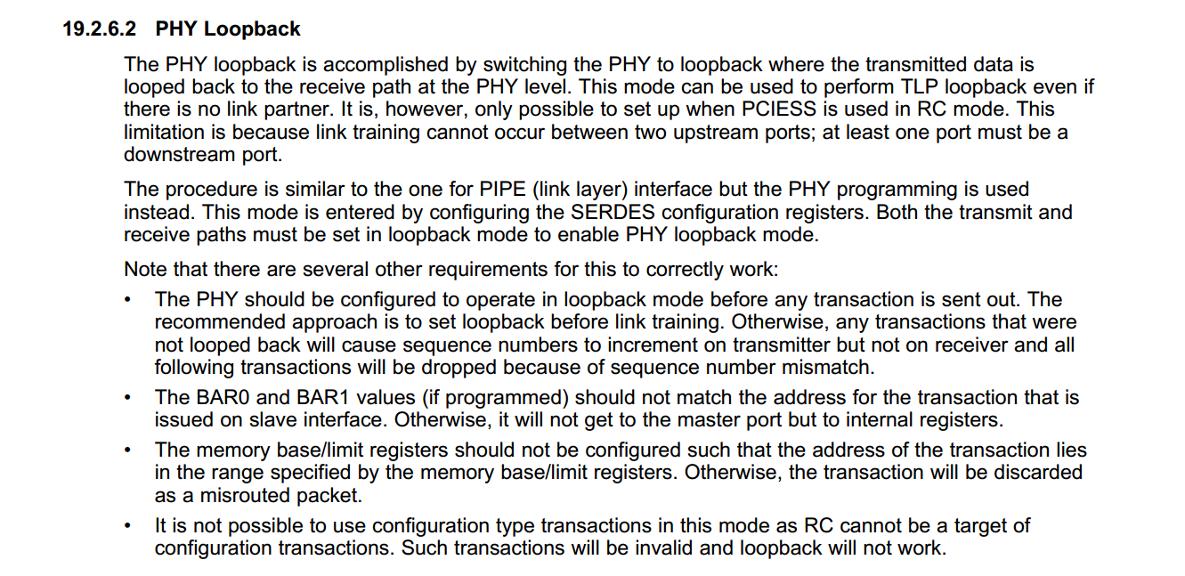

I use BB_008_PCIE_Test.out to test the pcie, I follow GEL scripts PG2.1_DM814X_20Mhz_Si.gel,when I execute  DM814X System Initialization --> PCIE_configure_RC_all,it will stop at rc_start_link_train() --> while((RD_MEM_32(PCIE_REGISTER_BASE + RC_PL_DEBUG0) & 0x1F) != 0x11);It seems that pcie link train is not ok.So I want to set the pcie on phy loopback mode.I saw somethings about it on the datasheet.
any configuration about it?
