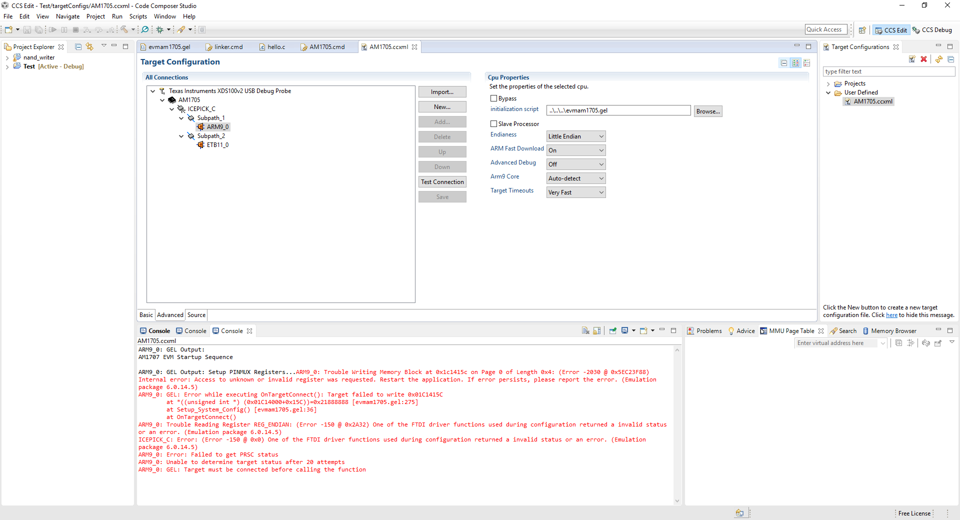

I've designed a custom board using an AM1705 hopefully running Linux. I however am struggling to program my board with the NANDWriter utility used for programming the NAND flash. I've managed to program the board using a simple hello_world program and that works fine. My problem has been narrowed down to the gel script (AM1707evm) where I get the following error:
ARM9_0: Trouble Writing Memory Block at 0x1c1415c on Page 0 of Length 0x4: (Error -2030 @ 0x64703F88) Internal error: Access to unknown or invalid register was requested. Restart the application. If error persists, please report the error. (Emulation package 6.0.14.5)
ARM9_0: GEL: Error while executing OnTargetConnect(): Target failed to write 0x01C1415C
at *((unsigned int *) (0x01C14000+0x15C))=0x21888888 [evmam1705.gel:278]
at Setup_System_Config() [evmam1705.gel:39]
at OnTargetConnect()
The location it is referring to is the PINMUX15 register. When I comment out that line then it crashes on the next register but none of the ones before.
I've also used the OMAP_L1xxx debugging script and I have attached the output of Run_All.
I've already checked the soldering on the ground pad as that was an issue on another post. I'm currently running the startup script with the hello_world program that I know works.
Any hints or suggestions will be greatly appreciated.

  • Hi Haydn,
    Actually my question to you is, when you do "connect target" using gel file you get this error ? or during loading the NAND writer program, you get this error. If it is during the loading stage, then the gel file runs and complete successfully??
    Before you load any program either it be "hello world" or the "NANDWriter ", you have to first do the following. Please do check all the steps and revert to us in which step you receive error.
    1. Open the *.cxml file and do test connection. make sure it gets succeed.
    2. Open the *.cxml file and go to advanced tab, click the CPU name and check that the appropriate gel file is located.
    2. Launch the *.cxml file.
    3. Right click on the processor device which gets displayed on the screen. Right click and do "connect target". Now the gel file will get run. Does the gel file runs completely or give error at thei stage??
    4. Load the program ( NAND writer / Hello world ) and hit run.
    Please post the screenshot with errors in CCS to us.

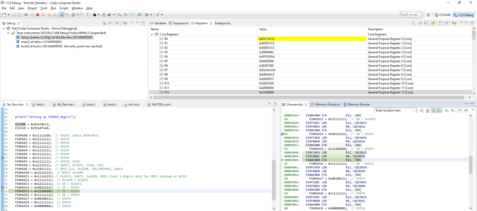

  • The program fails at the part when I right clicked and said "connect to target". It gave the following error:
  • After doing some further testing and rewriting the gel script into C code. I have been stepping through the assembly and can now pinpoint the instruction that causes the error:
    It is the darkest green instruction on the right. I've also included the registers to show that they are loaded with the correct values.

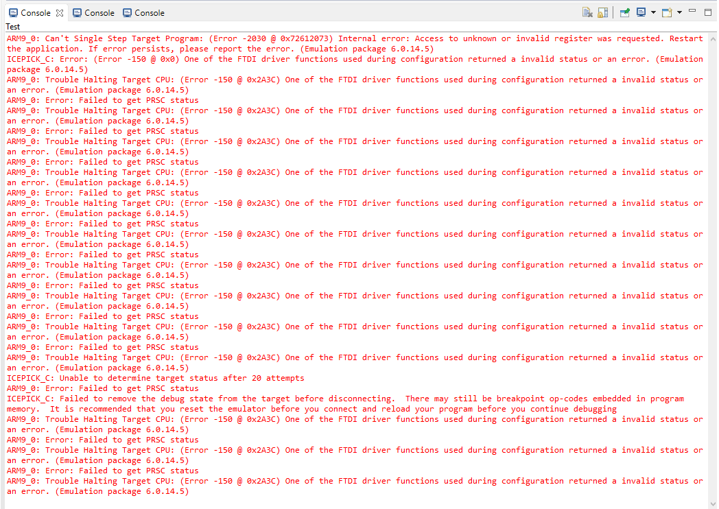

    The error has changed to this:
    When using the memory browser I can't change the values of the PINMUX registers from 15 to 19 but I can do it for all of the ones below 15.
    I'm thinking that I may need to setup another board unless you guys have some suggestions?

  • Suggest changing
    PINMUX14 = 0x88222222;
    to
    PINMUX14 = 0x00222222;
    The 8 values are reserved on th AM1705 but okay on AM1707. Perhaps 8s muxs in connections that result in a processor hang.
  • I can change them to GPIO mode. I then changed the values in the PINMUX registers that I would use in my application and it worked. It must have been the fact that I was writing a value that was reserved as Norman suggested earlier (I didn't try this because I assumed that TI wouldn't supply software that didn't work for the processor).
    When I change the Gel file then it also works! Thanks for the help! Time to go through the entire file and change everything.
