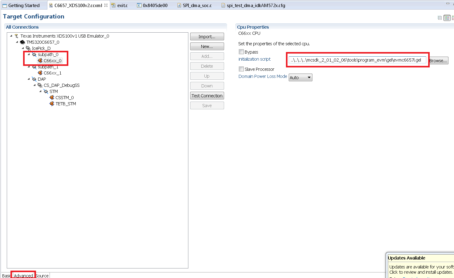

  • Peter,
    The target configuration and connecting to the EVM hasn`t changed much between CCSv5 and CCSv6. However, we have some generic CCS and EVM setup instructions with CCSv6 archived here:
    Create the target configuration for C6657 EVM and XDS200 emulator from New->Target configuration  and selecting XDS100v2 USB emultor and the device as TMS320C6657. IOpen the CCXML file and under Advanced Tab(bottom of the Tab),  select C66x_0 core and browse to the GEL file that is located at <CCS_INSTALL_DIR>\ccsv6\ccs_base\emulation\boards\evmc6657l\gel.
    Save the file and launch the target configuration.When you connect to the C66x Core 0,  you will notice in the console that the clocks, high memory and DDR, and PSC will be configured and the device will be initialized to run code on the it.
    Hope this helps. Please let us know if these don`t work for you and I will try to provide more screenshots that may help with the setup.
    Rahul
