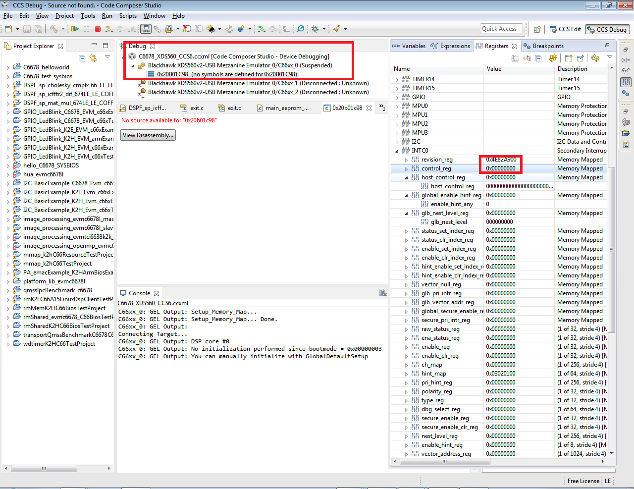

Can you please point me to the correct section or API in the CToolsLib for setting BRKEN.  I've looked through all of the documentation and don't see it anywhere.
Milan

    In C6678 TRM, I do not see any BRKEN register.
    However, in general, during run time, if you would want to change the value of any register bits, you can change directly like something below for testing purpose.
