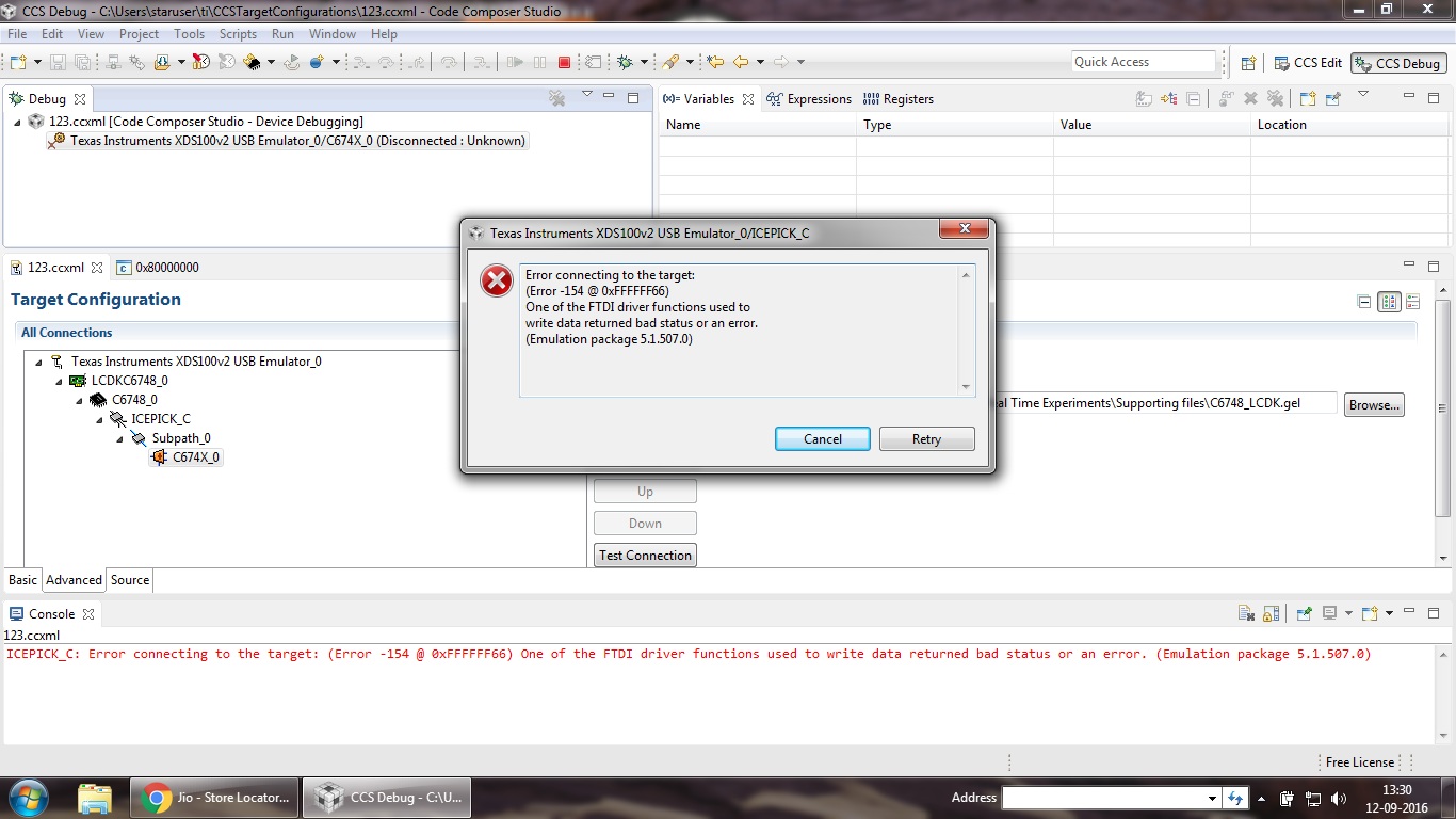

hi ,
I am using 6748LCDK board when i am trying to connect target i am getting error (attachment)
Hi Mohammed,
These are the suggestions.
1. Try disconnecting all the power cable, emulator cables between the PC and the target and reconnect it and try again.
2. Make sure that the emulation package is the latest one.
Just open up the *.ccxml file and do "test connection" and check the output messages.
