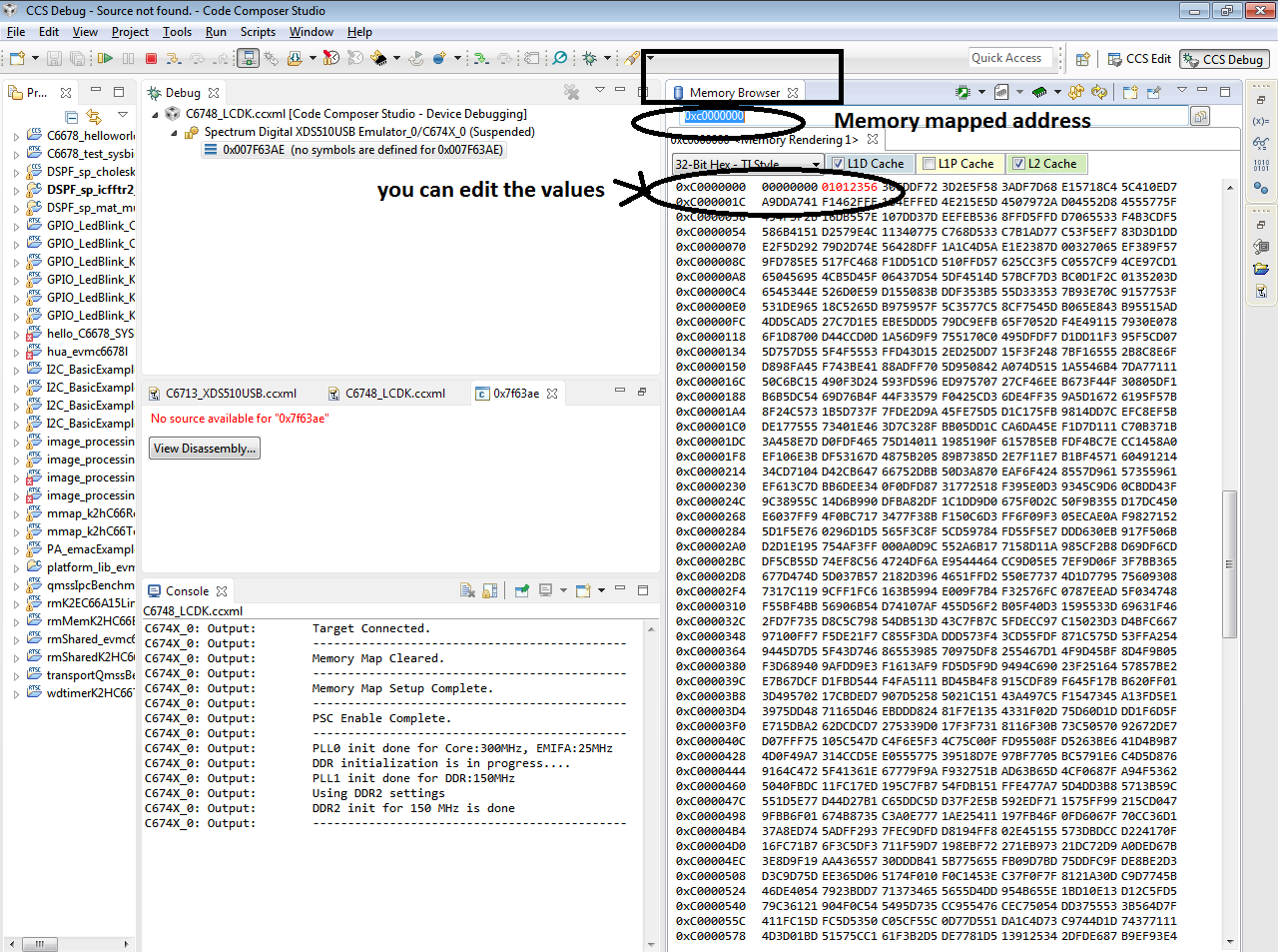

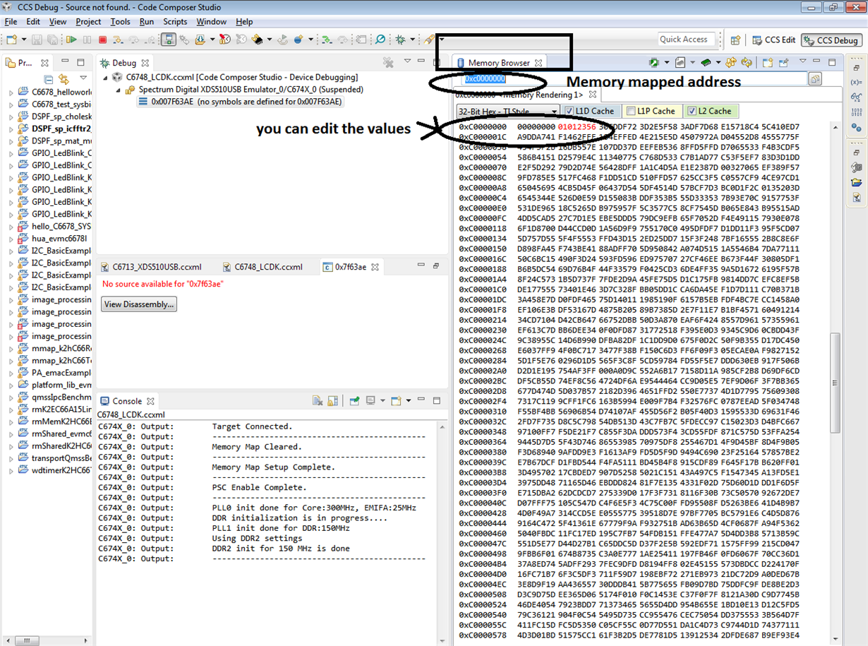

    Option 2:
    If you have configured all the parameters of EMIF and SDRAM, you can use the CCS Memory browser and do a read write directly into the memory mapped addresses of SDRAM.
    The window will show something like below.
