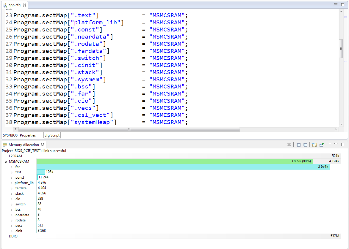

Now I would like to pcie boot project which uses BIOS and which is optimized for speed. I have made such project and checked that it works succesfully when I load it via 560v2. Because of BIOS and speed optimizations more space was required and thats why I put all the code into MSMCSRAM, which fits my purposes well - is fast and will be available for all cores.  Here is my memory map from BIOS .cfg file:
Program.sectMap[".data"] 			= "MSMCSRAM";
Program.sectMap[".csl_vect"] 		= "MSMCSRAM";
Program.sectMap[".text"] 			= "MSMCSRAM";
Program.sectMap["platform_lib"] 	= "MSMCSRAM";
Program.sectMap[".const"] 			= "MSMCSRAM";
Program.sectMap[".neardata"] 		= "MSMCSRAM";
Program.sectMap[".rodata"] 		    = "MSMCSRAM";
Program.sectMap[".fatdata"] 		= "MSMCSRAM";
Program.sectMap[".switch"] 			= "MSMCSRAM";
Program.sectMap[".cinit"] 			= "MSMCSRAM";
Program.sectMap[".stack"] 			= "MSMCSRAM";
Program.sectMap[".sysmem"] 			= "MSMCSRAM";
Program.sectMap[".bss"] 			= "MSMCSRAM";
Program.sectMap[".far"] 			= "MSMCSRAM";
Program.sectMap[".cio"] 			= "MSMCSRAM";
I have succesfully converted the out file to .h file with a help of helloworld_elf2HBin.bat. The projected is booted, BIOS starts (I suppose that is does, because I programmed the LED to blink in IDLE thread), but nothing more works in the project - no interrupts, no math, no data transactions over PCIE. Probably I have the same problem which was discussed in this thread: https://e2e.ti.com/support/dsp/c6000_multi-core_dsps/f/639/t/136505  not all the sections are loaded, but not sure. Also maybe I am doing something wrong in DSP boot sequence: first EVM init + interrupt configuration via CSL, than from main: bios_start and start_boot.

  • Hello, Iding!
    Thank you for your answer.
    No I can't do that because I can't fit my sections into L2 cache. In my project I have to dynamically allocate large ammount of memory in order to store data vectors there, that's why I have large stack section, I also have bios and speed optimizations and so on... I suppose that MSMCSRAM is not the best place to do that, but it is faster than DDR3 and fits my purposes right now as a temprorary test variant.

    Here is the memory map of my BIOS project (from .cfg) file and memory allocation graph:
    In main I do the following:
    main()
     platform init + memory init (in init BIOS block);
     CIC configurations via BIOS API;
     BIOS_start();
     start_boot();
