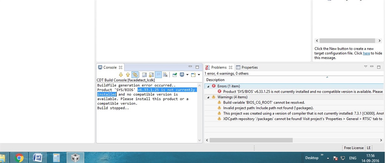

Hai Sir,
I am doing video processing(Face detection) by importing project from SDK after connecting with target when i import and try to build it is showing error as SYS/BIOS v6.33.1.25 is not currently installed and installed SYS/BIOS v6.33.1.25 but still problem remains

    You should install the SYSBIOS version under 'ti' folder.
    E.g:
    C:\ti\bios_6_35_04_50
    After that you have to restart the CCS and update the newly installed packages into CCS database then you will be able to use the SYSBIOS in your project.
