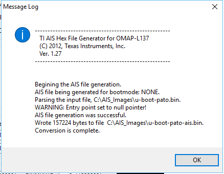

Then using AISgen for D800K005 and the u-boot.bin image I created an AIS image. The settings are the following:
The message log was the following:
There is a WARNING: Entry point set to null pointer!
Is this a problem?

  • Your code changes look okay. I am guessing things break down at the AIS image creation. You changed a lot of things all at once. It would have been better to build your own version of the pre-built UART2 u-boot to test the entire build and program process. Then change one thing at a time. Some guesses...
    AISgen is graphical wrapper to the console program HexAIS. AISGen produces an INI file and command line for HexAIS. The command line is logged out to a TXT file. All these files are in the install directory. I experimented with feeding the command line and INI file to HexAIS in a command window. Seems that this verison of HexAIS
    - does not like .bin files.
    - does not support the @<Addr> for specifying a entry point.
    - does support -entrypoint <Addr>
    - does accept ELF files.
    - does accept .out(COFF?) files.
    The compilation of u-boot produces an ELF file by default. Rename u-boot to u-boot.elf and use that instead of u-boot.bin. The ELF file should define an entry point. You might be able to specify the entry point option as part of the file name in AISgen. Something like:
    u-boot.elf -entrypoint 0xC1080000
    or
    -entrypoint 0xC1080000 u-boot.elf
    The UBL approach suggested by Titus more closely matches the OMAP-L137 sequence of bootloading
    1. RBL (ROM Bootloader on the DSP)
    2. UBL (DSP)
    3. UBL (ARM)
    4. u-boot (ARM)
    5. linux (ARM)
    The AM17xx does not have an DSP, so a modified OMAP-L137 way would be
    1. RBL (ROM Bootloader on the ARM)
    2. UBL (ARM)
    3. u-boot (ARM)
    4. linux (ARM)
    In both cases, AISgen has been written to assume that first thing after RBL is a UBL in .out format. This version of AISgen has not been updated since 2012 to support removal of the redundant ARM UBL.
    The OMAP-L138 is an ARM boot device and I remember it's boot sequence originally has the ARM UBL. Later the sequence was eventually reduced to
    2. u-boot (ARM)
    3. linux (ARM)
    I think AISgen in this case supports a .bin format but the OMAP-L138 AISgen is not compatible with AM17xx devices.
  • Hello Titus and Norman,
    Thank you very much for your help.
    After some struggling before checking your advice,  I tried the to generate the AIS file without using the AISgen tool. I'm using Windows 10 right now and because I have experienced some trouble in the past with some programs, I decided to run HexAIS in a command window.
    HexAIS_OMAP-L137.exe -ini AISgen.ini -o u-boot-ais.bin -entrypoint 0xc1080000 u-boot.bin@0xc1080000
    The AISgen.ini file was taken from the AISgen tool directory.
    The file u-boot-ais.bin was created as a product of the HexAIS_OMAP-L137.exe execution,
    Then it was sent to the AM1705 with the following line:
    sfh_OMAP-L137.exe -targetType AM1707 -flash_noubl -v -p "COM6" u-boot-ais.bin
    I changed the jumpers to boot from SPI0 source and re-applied power.
    This time the U-boot prompt was showing fine in a terminal application. It shows a lot of problems, as you can see below, but for this post the only goal was to be able to see the Uboot prompt sent from UART1.
