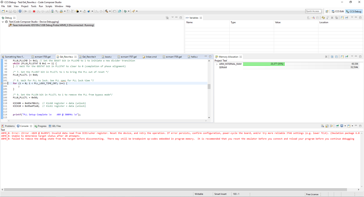

Hi all,
After sorting out the previous problem with the Gel script I have been going though it and writing my own based on the AM1707 script. However when I run it, there are still problems. The device becomes unresponsive very similar to before but I've checked that I'm not writing anything to reserved bits this time.
Here are the screenshots of the errors:
I have also tried converting the Gel script to a C file and building it as part of the project with little success. What I have noticed however is that it seems to be halting at different time nearly every time I run it which is making it quite hard to debug. Any help will be greatly appreciated.
I've attache the Gel Script belowevmam1705.gel
  • This error is occurring while accessing the PTCMD register of PSC (for PSC0 EDMA3 CC0).
    You said, that you were able to success by converting this gel to C code, sounds like CCS is the problem for running the gel script (executing the gel script)
    If its possible, try to run this gel in CCSv5.
  • My apologies when I said with little success I meant that it didn't work either. The processor hung at the PLL configuration and then when I reloaded it then hung during the PSC configuration.
    I'm going to install CCSv5 and see if that makes any difference. I'm also going to update to the latest CCSv6 as it seems to have some fixes for flashing devices.
  • I have tried CCSv5.5 and I get the following error:
    and then when I've rewritten the GEL script into C code I get the following:

  • The above error occurs during printf("Setup Power Modules (All on)... "); After commenting out this line then it runs till I try and setup PSC0_MDCTL3 =0x3. This causes the same error to occur.
  • I assumed you started with a working evmam1707.gel file and then made changes for the AM1705. Maybe try rolling back your changes one by one until things start to work.
    Maybe add back the call to Disable_IRQ_Flush_Cache() and all the contents of Disable_IRQ_Flush_Cache(). The function seems to do more than disable IRQ. It apparently puts the processor is supervisor mode and disables the MMU. I think both of those are needed. The KICK unlock is commented out as well. In theory, out of reset, the KICK should already be unlocked. Unless KICK has been disabled like in later 6748 versions. Then don't bother.
  • I started with the AM1707 gel script from Spectruum Digital, support.spectrumdigital.com/.../evmam1707.gel which doesn't have the Disable_IRQ_Flush_Cache() function at all. But I've found a gel script for either the AM1808, OMAP137 or OMAP138 that has it and I'll have a look at that and include it.
    Yes the KICK registers have been commented out at the end of the PLL setup as they were causing the program to hang which I thought was quite bizarre. The registers are written to at the start of the Setup_System_Config() call and I always run that one first to ensure that they are unlocked.

  • I've tried your file and the one that comes with the installation (1777.evmam1707.gel)
    and I'm still getting errors. I've had to change the PINMUX registers and some of the PLL configs as my AM1705 is configured for 375MHz. I also tried it with both of the scripts:
    Test 1: AM17xx Starterware Gel
    Change the PINMUX registers to match my previous script and the PLL config to match my previous script. The following error was observed:
    Test 2: CCS Gel Script
    I change the PINMUX registers to be all set to GPIO and the PLLM variable to be 15 for a clock of 360MHz. The following error was observed:
    The errors are the same regardless of if the OnTargetConnect() function is called or if I manually run through them using the scripts menu. What is interesting is that they seem to occur at different times. Using Test 1's Gel and stepping through the functions I found that changing the KICK1 register in the PLL setup was causing the error however when running through it with the Target Connect call then it ran to point as shown in the screenshot.

    From what I can see, in the first 3 scenarios, the processor has hung after PLL setup. It implied that PLL has not locked and the processor clock is unstable. I am guessing scenario 4 fails on the script line that enables the PLL clock to the processor. Seems slower speed results in immediate fail. You could try commenting out that line only:
    PLL0_PLLCTL |= 0x1;
    Your GEL script should complete but the processsor will by running at a really slow clock. Peripherals like the UART won't be happy. Perhaps get your HW guys to check all the PLL components.

  • This is the output when the CLKMODE lines are still commented out:
    ARM9_0: GEL Output: Setup PINMUX Registers...ARM9_0: GEL Output: [Done]
    ARM9_0: GEL Output: 0.PLL0_PLLCTL = 0x00000072
    ARM9_0: GEL Output: 1.PLL0_PLLCTL = 0x00000072
    ARM9_0: GEL Output: 2.PLL0_PLLCTL = 0x00000052
    ARM9_0: GEL Output: 3.PLL0_PLLCTL = 0x00000052
    ARM9_0: GEL Output: 4.PLL0_PLLCTL = 0x00000050
    ARM9_0: GEL Output: 5.PLL0_PLLCTL = 0x00000050
    ARM9_0: GEL Output: 6.PLL0_PLLCTL = 0x00000050
    ARM9_0: GEL Output: 7.PLL0_PLLCTL = 0x00000058
    ARM9_0: GEL Output: 8.PLL0_PLLCTL = 0x00000058
    ARM9_0: GEL Output: 9.PLL0_PLLCTL = 0x00000000
    ARM9_0: GEL Output: PLL Setup Complete
    ARM @ 300MHz
    ARM9_0: Trouble Reading Memory Block at 0xfffd3fa0 on Page 0 of Length 0xc
    ARM9_0: Trouble Reading Memory Block at 0xfffd3fa0 on Page 0 of Length 0x90
    ARM9_0: Error: (Error -1034 @ 0x400) Data bus is 'not ready'. Choose 'Abort' to try to abort the pending transaction. Choose 'Force' to try to force the bus ready state. (Emulation package 6.0.407.6)
    ARM9_0: Error: (Error -1035 @ 0x2EE0) Device state appears corrupt after a hung bus. Power-cycle the board. If error persists, confirm configuration and/or try more reliable JTAG settings (e.g. lower TCLK). (Emulation package 6.0.407.6)
    and this is with it enabled:
    ARM9_0: GEL Output: Disable IRQ/FIQ
    ARM9_0: GEL Output: Flush Data Cache
    ARM9_0: GEL Output: Flush Instruction Cache
    ARM9_0: GEL Output: Disable MMU
    ARM9_0: GEL Output: 9.PLL0_PLLCTL = 0x0000005D
        ARM @ 300MHz
    ARM9_0: Trouble Reading Memory Block at 0xfffd3fa0 on Page 0 of Length 0x60
  • Looking at the PLLCTL values, the "Enabled" case looks better. The "Commented Out" case is the same until the end where PLLCTL = 0. In both cases, the GEL script does not run to completion. Weird stuff is that reserved bits PLLCTL are not what they documented to be in the TRM and change during the PLL init.
    The next line "Setup Power Modules (All on)... " never appears. The debug output says it can't read 0xfffd3fa0, which according to the datasheet is ARM local ROM. Probably the boot ROM code. No idea why boot ROM is involved. It should have finished running assuming your boot mode pins are strapped for emulation boot. You should double check that.
    The printing changes the timing, that may be why both cases fail now. A real puzzle.
  • I checked the BOOTCFG register and that is set to the right values for emulation boot. I was previously running it by right clicking on target configuration and selecting launch configuration and so it didn't have a program loaded in. I think the emulation boot mode just causes it to loop back to a single instruction which is stored in the ROM. This is what I'm getting from the disassembly.
    Following this line of thought I tried to run the gel script once a program is loaded into its memory and it's waiting at the main() call (note: I've included a boot.c and set the linker to call that first. The boot.c code is based on the AM1707 User Bootloader that comes with the SDK.). When the GEL is run from there I get the following:
    ARM9_0: GEL Output:
    AM1707 EVM Startup Sequence
    ARM9_0: GEL Output: 2.PLL0_PLLCTL = 0x00000072
    ARM9_0: GEL Output: 3.PLL0_PLLCTL = 0x00000072
    ARM9_0: GEL Output: 4.PLL0_PLLCTL = 0x00000070
    ARM9_0: GEL Output: 5.PLL0_PLLCTL = 0x00000070
    ARM9_0: GEL Output: 6.PLL0_PLLCTL = 0x00000070
    ARM9_0: GEL Output: 7.PLL0_PLLCTL = 0x00000078
    ARM9_0: GEL Output: 8.PLL0_PLLCTL = 0x00000078
    ARM9_0: GEL Output: 9.PLL0_PLLCTL = 0x00000079
        ARM @ 300MHz
    ARM9_0: GEL Output: Setup Power Modules (All on)...ARM9_0: Trouble Writing Memory Block at 0x1c10120 on Page 0 of Length 0x4
    ARM9_0: GEL: Error while executing OnTargetConnect(): Target failed to write 0x01C10120
    	at *((unsigned int *) (0x01C10000+0x120))=(0x1<<PD) [evmam1705.gel:324]
    	at PSC0_lPSC_enable(0, 3) [evmam1705.gel:614]
    	at Setup_Psc_All_On() [evmam1705.gel:41]
    	at OnTargetConnect()
    ARM9_0: Trouble Reading Register REG_ENDIAN: (Error -150 @ 0x2A3C) One of the FTDI driver functions used during configuration returned a invalid status or an error. (Emulation package 6.0.407.6)
    ARM9_0: Trouble Reading Register REG_SYSTEM_TARGET_PSR: (Error -150 @ 0x2A3C) One of the FTDI driver functions used during configuration returned a invalid status or an error. (Emulation package 6.0.407.6)
    ARM9_0: Trouble Reading Register REG_SYSTEM_TARGET_CONFIG: (Error -150 @ 0x2A3C) One of the FTDI driver functions used during configuration returned a invalid status or an error. (Emulation package 6.0.407.6)
    ICEPICK_C: Error: (Error -150 @ 0x0) One of the FTDI driver functions used during configuration returned a invalid status or an error. (Emulation package 6.0.407.6)
    ARM9_0: Trouble Reading Register REG_SYSTEM_MMU_CONFIG: (Error -150 @ 0x2A3C) One of the FTDI driver functions used during configuration returned a invalid status or an error. (Emulation package 6.0.407.6)
    ARM9_0: Error: Failed to get PRSC status
    ARM9_0: Unable to determine target status after 20 attempts
    ARM9_0: Failed to remove the debug state from the target before disconnecting.  There may still be breakpoint op-codes embedded in program memory.  It is recommended that you reset the emulator before you connect and reload your program before you continue debugging
    Now when I try to use the right click for launch configuration I get the exact same output.
    Final Note: I have uncommented the // PSC0_lPSC_enable(0, 3);  // EMIFA line.
    When this is commented out then the GEL script runs to completion.
