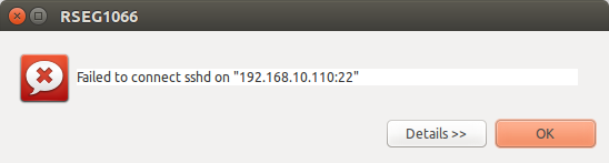

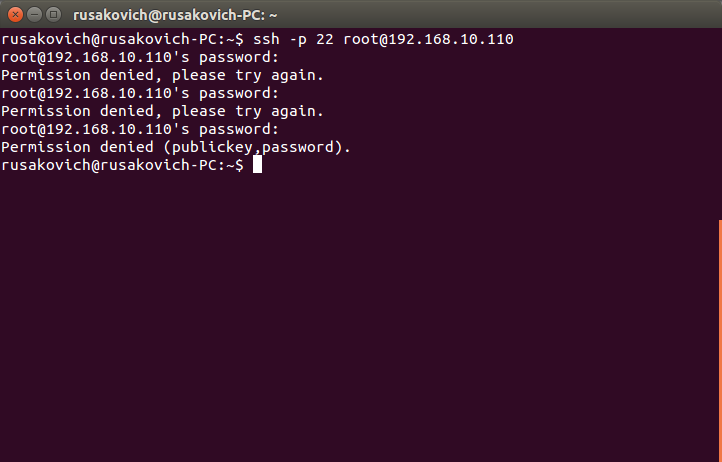

Hello
I'm trying to work with Linux on AM335x ICE using this tutorial: http://processors.wiki.ti.com/index.php/Processor_SDK_Linux_Training:_Hands_on_with_the_Linux_SDK
I've already wrote am335x-evm-linux-rt-03.00.00.04.img on SD card and run it.
But the problem is when I try to connect to board by SSH (in Ubuntu Terminal or in CCS6 Remote System Explorer) a password is required.
I try to use blank password as it described in the tutorial but it no has effect.
I can't understand why this password isn't blank and how to connect.

  • Hi Aleksei,
    This seems quite strange.. have you modified anything in your linux kernel? Any systemd serivces or something else?

  • Hello Yordan,
    Thank you for your help!
    The mistake was I haven't configured static IP of the board.
    But I have one more (maybe quite stupid) question:
    When I connect to the board via UART and setup static IP then I can connect via SSH. But after reboot I have to set IP again.
    I've tried modifying file /etc/network/interfaces to set static IP permanently, like this
    auto eth0
    iface eth0 inet static
    address 192.168.10.110
    netmask 255.255.255.0
    but it has no effect.
    Is there any way to save board's IP?
    Many thanks!
    Aliaksei
