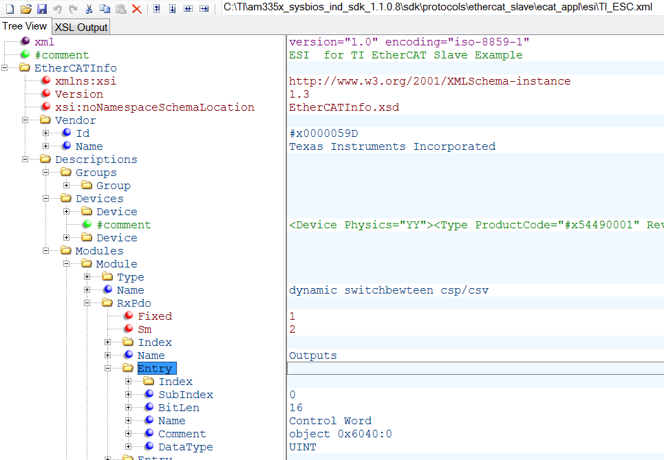

    I tried exporting the eni file using TwinCat 3 and generated MasterENI.c file .
    But in the exported ENI file, I dont see the product ID/vendor Id/any slave information in the ENI.xml but State machine information.
    I see from the reference document, I have to use EC-Engineer tool to generate the ENI file.  TwinCat will not help in this regard?
    If so, could you please help me how to generate ENI using TwinCat. Im not able to download evaluation version of EC-Engineer tool.

    Thanks for your reply. My problem is regarding that I am trying to modify the object 0×6040 which is actually the control word to enable the slave using the SDO transfer.
    So, my doubt is whether it is correct to modify the control word 0x6040 using the SDO or control word can only be modified using PDO ?
    The reason for asking this question is when I am trying to modify the control word using SDO transfer , it is coming to be a success, but it can't be able to modify the control word.
    My next doubt is if the control word is to be modify using the PDO in the ENI FILE , then can you help me in how can I modify it ?
    Thanks very much for your time. I really appreciate in answering my doubts.
    Mohit

  • Hi Mohit, from TI_ESC.xml file I see we have control word 0x6040 already in the PDO (attached snapshot). If I recall correctly we use this XML to create ENI file.. but please double check, I would suggest to re-create your ENI file following "appendix B" from the TI design document.
    About your question on where to correctly change ControlWord6040, I believe it is in the PDO, however, you can post your question on ETG forum for additional guidance.
