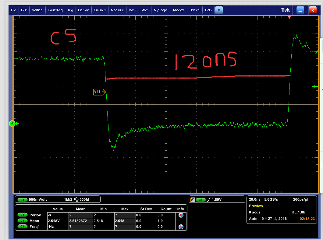

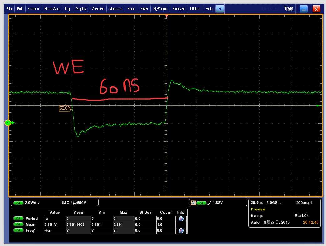

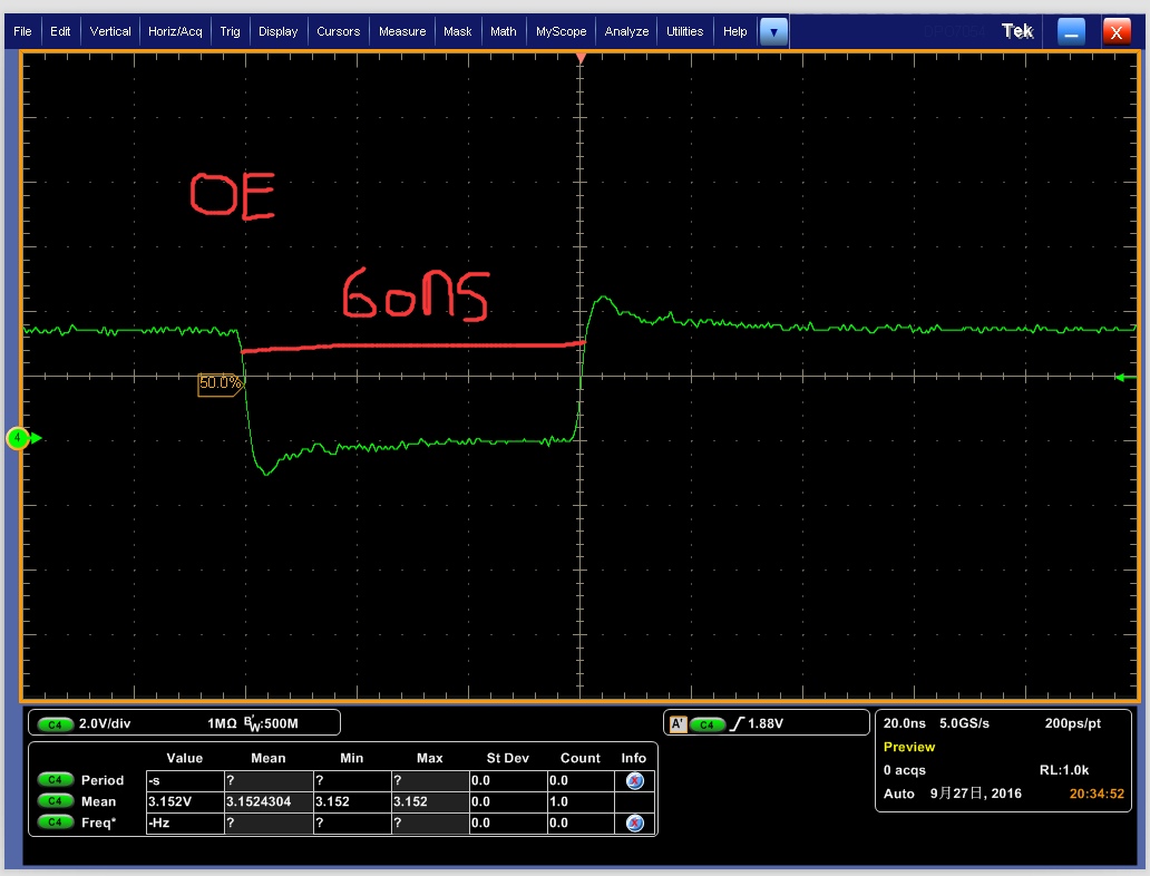

I use GPMC  Asynchronous access NOR flash
GPMC_FCLK frequency = 100Mhz
TIMEPARAGRANULARITY = 0h
GPMC_CONFIG2_0 = 0x70701;
CSRDOFFTIME = 0x7
CSWROFFTIME = 0x7
CSONTIME =0x1
I was using this formula:   For single read: A = (CSRdOffTime – CSOnTime) × (TimeParaGranularity + 1) × GPMC_FCLK
when  TimeParaGranularity = 0x0;
A= (7 - 1) * (0 + 1) * 10ns
= 60ns
but  ,By testing the value of the CS  signal time effectively  is  "120ns"
I was depressed for a long time.
Is there any problem with my setting?
