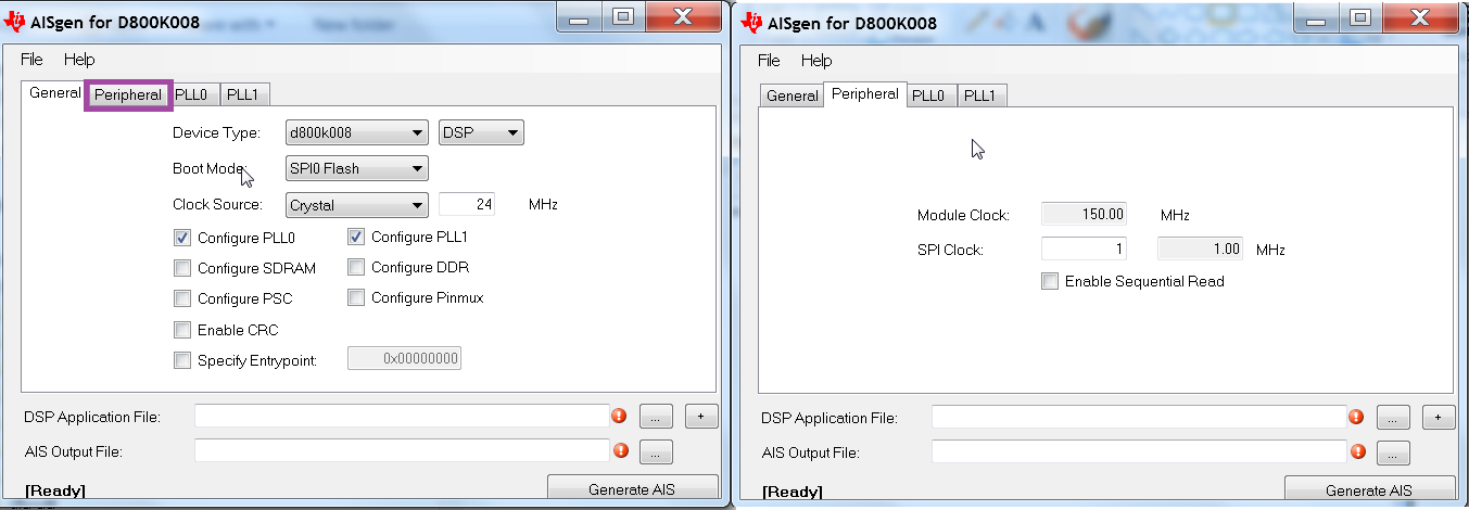

  • Hello Mukul,
    I located the error and it has to do with buffers propogation delay on the SPI lines that interfires with the timing of the interface.
    How do I reduce the  clock rate? How do I set the Bypass mode for the clock?
    The reference clock rate is 24MHz, the SPI clock in the current settings is 50MHz.

  • Hi Svetlana
    For booting, you would've created your AIS Image, where you have the ability to set the PLL0 (CPU frequency) as well as SPI frequency etc.
    Do note that 50 MHz is likely too high for booting from SPI flash.
    The boot loader application note , section 5 has some guidance and also has the following para
    For SPI and I2C master modes, you can enter a desired speed. Depending on the PLL settings and
    granularity in peripheral clock division, AISgen calculates the actual speed nearest to the desired speed
    and shows it in an adjacent box. Recent I2C devices support speeds up to 400 kHz, and SPI devices
    support speeds up to 33 MHz.
    You should try to reduce the speed to 33 MHz or lower.
  • Svetlana,
    The clock rate can be modified by changing the AIS settings when creating the boot image as shown in the screenshots below:
    Hope this helps. By setting the PLL0 you can configure the SYStem clocks.
