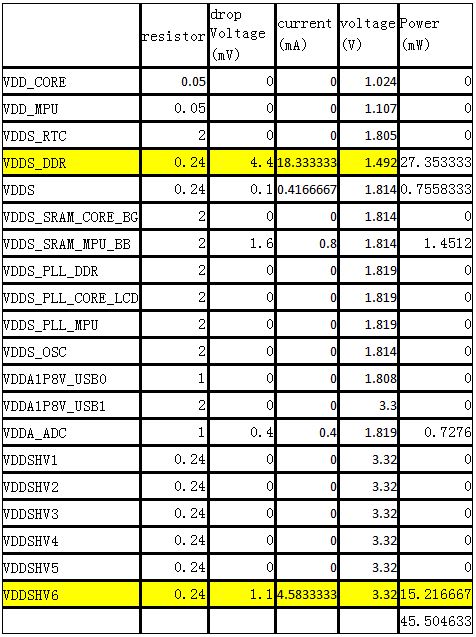

  • Hi Mukul & Mike:
      Highly appreciate for your help on this case!
      Sorry for the late response due I was tied to customer issue support yesterday.
      Today I reproduced this issue on  another GPEVM, 1.6A. My latest result is as below:
      I measured the VDDS_DDR and VDDSHv6 power rails, which contribute a lot to the final big numbers.
    1. For the VDDSHv6 power rails, the result is the same.
    2. For the VDDS_DDR, I measure the J41 connector, which marked VDDS_DDR, the result is the same. But for J20 connector, which marked AM335x_VDDS_DDR, it is almost Zero.
    I’m curious of the J41 connector, which marked VDDS_DDR, what’s this power rail used for?
    I try to search the description of the J41 connector on the wiki, but failed as wiki has some problem today, couldn’t be accessed.
      In addition, attached is the full log of booting and suspend process.
      Could you help to let me know your comments on this? Many thanks!
    Test result highlight in my test:
    resistor
    drop Voltage
    (mV)
    current
    (mA)
    voltage
    (V)
    Power
    (mW)
    VDD_CORE
    0.05
    0
    0
    1.024
    0
    VDD_MPU
    0.05
    0
    0
    1.107
    0
    VDDS_RTC
    2
    0
    0
    1.805
    0
    VDDS_DDR
    0.24
    4.4
    18.333333
    1.492
    27.353333
    VDDS
    0.24
    0.1
    0.4166667
    1.814
    0.7558333
    VDDS_SRAM_CORE_BG
    2
    0
    0
    1.814
    0
    VDDS_SRAM_MPU_BB
    2
    1.6
    0.8
    1.814
    1.4512
    VDDS_PLL_DDR
    2
    0
    0
    1.819
    0
    VDDS_PLL_CORE_LCD
    2
    0
    0
    1.819
    0
    VDDS_PLL_MPU
    2
    0
    0
    1.819
    0
    VDDS_OSC
    2
    0
    0
    1.814
    0
    VDDA1P8V_USB0
    1
    0
    0
    1.808
    0
    VDDA1P8V_USB1
    2
    0
    0
    3.3
    0
    VDDA_ADC
    1
    0.4
    0.4
    1.819
    0.7276
    VDDSHV1
    0.24
    0
    0
    3.32
    0
    VDDSHV2
    0.24
    0
    0
    3.32
    0
    VDDSHV3
    0.24
    0
    0
    3.32
    0
    VDDSHV4
    0.24
    0
    0
    3.32
    0
    VDDSHV5
    0.24
    0
    0
    3.32
    0
    VDDSHV6
    0.24
    1.1
    4.5833333
    3.32
    15.216667
    45.504633
