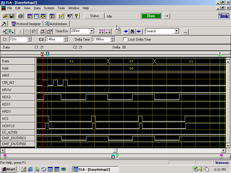

    EMIF:
    Clock Freq = 200 MHz (as configured on the DSK6455 board by default and can be seen on Page A-4 of http://c6000.spectrumdigital.com/dsk6455/v2/files/6455_evm_techref.pdf )
    Select Strobe Mode disabled, Write Enable Mode disabled, 16-bit data bus, asynchronous memory select, async ready input enabled (polarity low)
    W_setup = 15, W_strobe = 32, W_hold = 7
    (yes I realize these are very large values, and I've calculated the acceptable ranges of these values, but I am just ensuring that the signal lines and data buses are holding on for long enough).
    A couple things to note in the Logic Analyzer screengrab below is that what is labeled as HCNTL0 is actually ABA1 from the C6455.  HCNTL0 is wired to a switch which I have verified is logic level low.  EMIF_EN (top of EMIF_EN/DIR pair) is a CPLD control signal for enabling the bus transceiver which drives the EMIF signal lines to the external connector, and EMIF_DIR (bottom of EMIF_EN/DIR pair) is the direction signal to the bus transceiver.  This polarity (logic level low) is correct, according to the datasheet (though contrary to the DSK6455 documentation).  The bus transceiver datasheet can be found here: http://focus.ti.com/lit/ds/symlink/sn74lvth16245a.pdf
    One thing I notice is that the control signals seem to be at least twice as long as configured.  The durations of the control signals I've calculated from the logic analyzer are below the screenshot.
    HCS: 596ns
    HCS Asserted -> HDS2 Asserted: 168ns
    HDS2: 344ns
    Addr. Asserted (as measured by duration of HCNTL0 which is actually ABA1): 604ns
    Data Asserted: 644ns
    Addr Deasserted -> Data Deasserted: 212 ns
  • A quick correction in my previous post: "This polarity (logic level low) is correct, according to the datasheet (though contrary to the DSK6455 documentation)." should read "(logic level high)".  Though in the DSK6455 documentation it says that this signal should be 0 for writes, it should actually be 1 according to the datasheet.

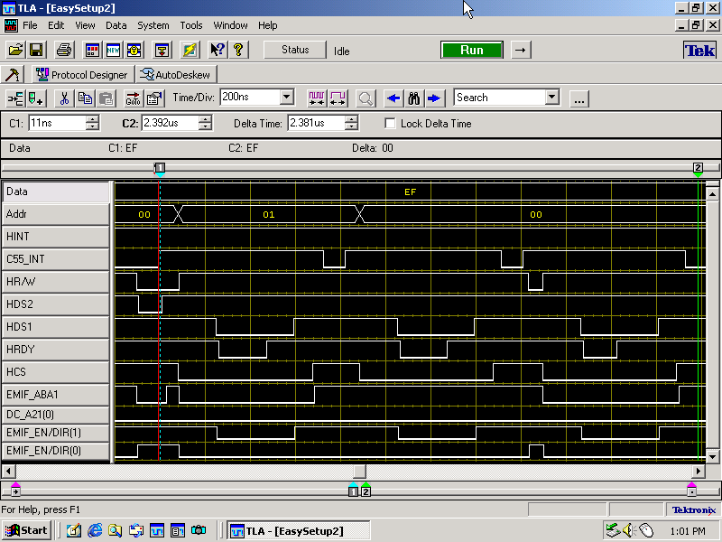

    During HPI Read operations, HRDY is asserted shortly after the data strobe (HDS) is asserted (i.e. time E7 of p.79, sprs0760 "TMS320VC5510 Fixed-Point Digital Signal Processors", and p.3 of spraa24 "HPI Throughput and Optimization"). In my configuration, the assertion of HRDY causes the 6455 to extend the read strobe period as expected.  During HPI Write operation, however, HRDY is asserted shortly after the data strobe is deasserted (time E9 of the same p.79, and p.4 of spraa24 "HPI Throughput and Optimization").  According to the EMIF User's Guide, the ARDY signal must be asserted "by the second rising edge of the ECLKOUT pin before the end of the programmed strobe period," which will never happen.  It would seem that these are incompatible signal combinations, as I understand them.  Or is my understanding of their use incorrect?  Another thing is that I never see the HRDY signal being strobed by the 5510 during HPIC accesses (Write or Read).  Is the HRDY signal only asserted during HPID accesses?
    Another question I have is regarding the EHPI data bus holders which are enabled through the 5510 SYSR system register.  When I have them enabled, I always read back the last thing written on the bus, and when I have them disabled, I'll often read back 0xFF (both HPIC/HPID).  From what I understand, these bus holders should be enabled in good design practices.  Is this correct?
    I'll follow up with an HPID Read/Write logic analyzer grab.
  • Okay, below I have HPID write/read logical analyzer screengrabs.  Note that only the 8 LSBs of the data and address buses are probed.  For the write, I write to 3 consecutive addresses the values 0xFACE, 0xDEAD, 0xBEEF.  For the read, I try to read these 3 consecutive addresses.  Note that during the read, the only values on the data bus are that which were written last - i.e. 0xEF.  All control signals look good, and the HRDY signal is strobing as if the data is being properly extracted from the buses to memory.
    Write:
    Read:
  • One more quick question: If my 5510 breaks off into the ISR set up for the DSPINT bit in the HPIC control register (i.e. HWI 10), can I conclude that HPIC writing is functioning properly?  I've been proceeding with the simple answer of "yes" but maybe I'm wrong.
    I cannot envision any scenario which would cause HPIC writes to function properly but not allow reading of this register, in addition to not allowing writing/reading of HPID, but perhaps someone else can think of one.
