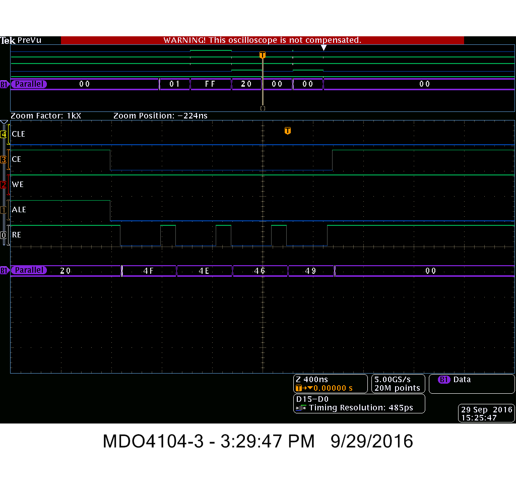

We have a custom board design that has a 66AK2H12 with the EMIF connected to a Micron MT29F8G16ADBDAH4 NAND flash. This is a 16-bit wide, ONFI-compliant flash with all 16 bits connected to the EMIF. If I boot the Keystone 2 from the UART, U-Boot sees the NAND, reads it, writes it, loves it, wants to get married to it, everything is groovy. But if I put the U-Boot image itself in the NAND flash and configure the BOOTMODE pins so that the RBL will try to boot from flash, nothing works.

So, in desperation I probed the EMFI and saw the following transactions on my oscilloscope:
1. RBL resets NAND
Next, RBL issues a READID command (0x90) to address 0x20:
NAND replies with the four-byte magic number 0x49464E4F (ASCII for ONFI):
RBL issues another reset, then a READID (0x90) to address 0x00:
The NAND replies with its device ID
And, after that, as far as I can tell, there are no more transactions on the EMIF.
So what's going on? Is there an erratum in the RBL? Is there a problem booting from a 16-bit NAND?
HELP!
