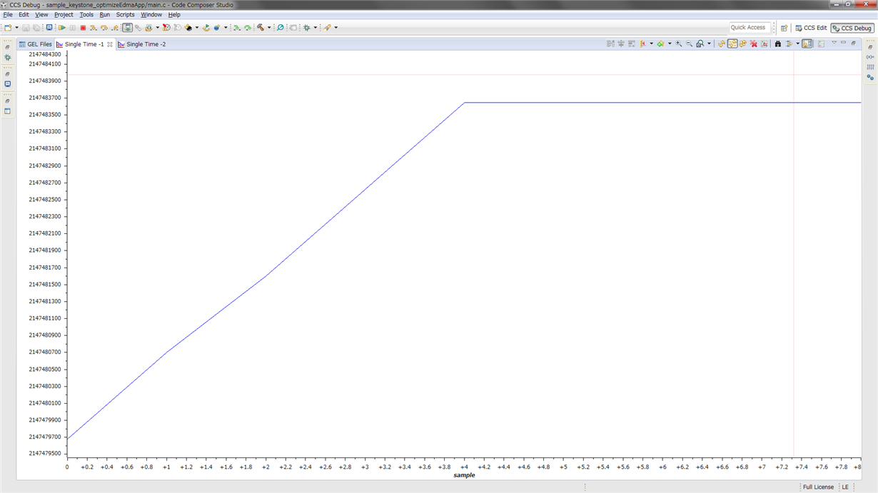

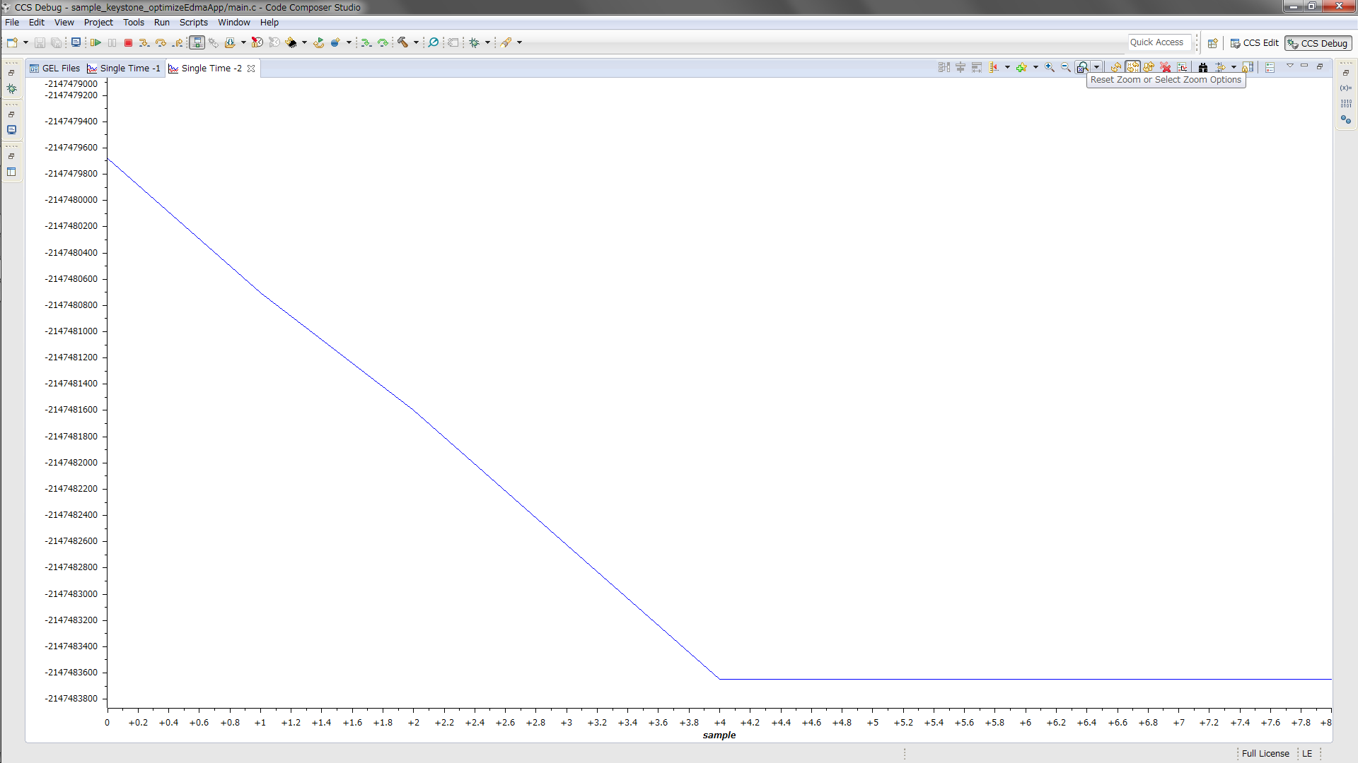

    Here is my investigation with small code:
    #include <c6x.h>
    #define TEST_SAMPLE_COUNT 9
    float g_floatArray_pos[TEST_SAMPLE_COUNT] = {
    		2.14748365e+09 - 0.00000400e+09,
    		2.14748365e+09 - 0.00000300e+09,
    		2.14748365e+09 - 0.00000200e+09,
    		2.14748365e+09 - 0.00000100e+09,
    		2.14748365e+09, //...(float)((int)0x7FFFFFFF) : Max integer in int type
    		2.14748365e+09 + 0.00000100e+09,
    		2.14748365e+09 + 0.00000200e+09,
    		2.14748365e+09 + 0.00000300e+09,
    		2.14748365e+09 + 0.00000400e+09,
    float g_floatArray_neg[TEST_SAMPLE_COUNT] = {
    		-2.14748365e+09 + 0.00000400e+09,
    		-2.14748365e+09 + 0.00000300e+09,
    		-2.14748365e+09 + 0.00000200e+09,
    		-2.14748365e+09 + 0.00000100e+09,
    		-2.14748365e+09, //...(float)((int)0x80000000) : Min integer in int type
    		-2.14748365e+09 - 0.00000100e+09,
    		-2.14748365e+09 - 0.00000200e+09,
    		-2.14748365e+09 - 0.00000300e+09,
    		-2.14748365e+09 - 0.00000400e+09,
    int g_intArray_pos[TEST_SAMPLE_COUNT];
    int g_intArray_neg[TEST_SAMPLE_COUNT];
     * main.c
    int main(void)
    	int i;
    	__float2_t f2_temp;
    	long long i2_res;
    	for (i=0; i<TEST_SAMPLE_COUNT; i++) {
    		f2_temp = _ftof2(g_floatArray_pos[i], g_floatArray_neg[i]);
    		i2_res = _dspint(f2_temp);
    		g_intArray_pos[i] = (i2_res & 0xFFFFFFFF00000000)>> 32;
    		g_intArray_neg[i] = (i2_res & 0x00000000FFFFFFFF);
    	return 0;
    After the completion, g_intArray_pos looks like:
    And the g_intArray_neg looks like:
    My customer wants to know this is expected behavior or not. For me, I think this should be expected, but this is not described in manual. So I'm asking.
