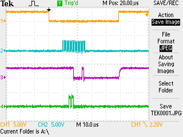

I am using the SPI_1 interface on the C6748.  The PinMux() is correctly configured.  All the four lines are active, CS[0], clk, somi and simo, and responding according to the spec.
I would like to use the chip select CSHOLD in the SPIDAT1 transmit register.  The CSHOLD works correctly except that there is a glitch on the CS line at the end of the first transfer.  This glitch causes the SPI slave to not respond with data.  See image below.  The traces from top to bottom are, CS[0], clk, somi and simo.
#define CS_HIGH   (0x01)
#define CS_LOW   (0xFE)
SPIDat1Config(SOC_SPI_1_REGS, (SPI_CSHOLD |  SPI_DATA_FORMAT0), CS_LOW);
SPIDefaultCSSet(SOC_SPI_1_REGS, CS_HIGH);
// order is c2edelay, t2edelay, t2cdelay, c2tdelay
SPIDelayConfigure(SOC_SPI_1_REGS, 0, 0, 100, 100);
CS_HIGH and CS_LOW can also be set to 0x01 and 0x00, but the behaviour is the same.
An external pulldown resistor on the CS[0] line does not make a change.
Various settings of the delay values does not make a change.

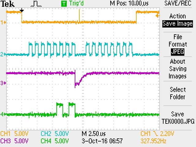

Note the glitch on the CS[0] line.  Why is the C6748 SPI_1 interface doing this?

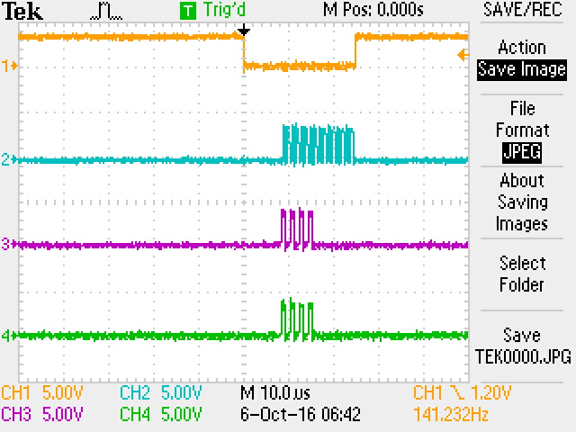

if the CS[0] line is instead configured as a GPIO line and the CS line is controlled externally, the CS[0] line behaves correctly.  See the image below.
Note there is no glitch on the CS[0] line and the SPI slave responds correctly.

  • The TRM would suggest that CSHOLD is self clearing. Is your code using interrupt, dma or polled IO? With polled IO, you may need to call SPIDat1Config() before each SPITransmitData1(). StarterWare has interrupt and edma examples that appear to handle CS hold properly without calling SPITransmitData1(). Some weirdness there.
  • Norman,
    Thanks for your post, this was helpful.
    The problem occurred, because I set up a loop to view the SPI transactions on the scope, but failed to see that the very first SPI transaction worked correctly.
    My test routine is using interrupts and on the last SPITransmitData1() CSHOLD is cleared, but the routine failed to reset the CSHOLD bit at the start of the next transaction.
    So now the SPIDat1Config(CSHOLD) is called before each transaction request is initiated, and SPIDat1Config() is called before the last byte which clears the CS line.  Works perfectly.  Thanks again.
