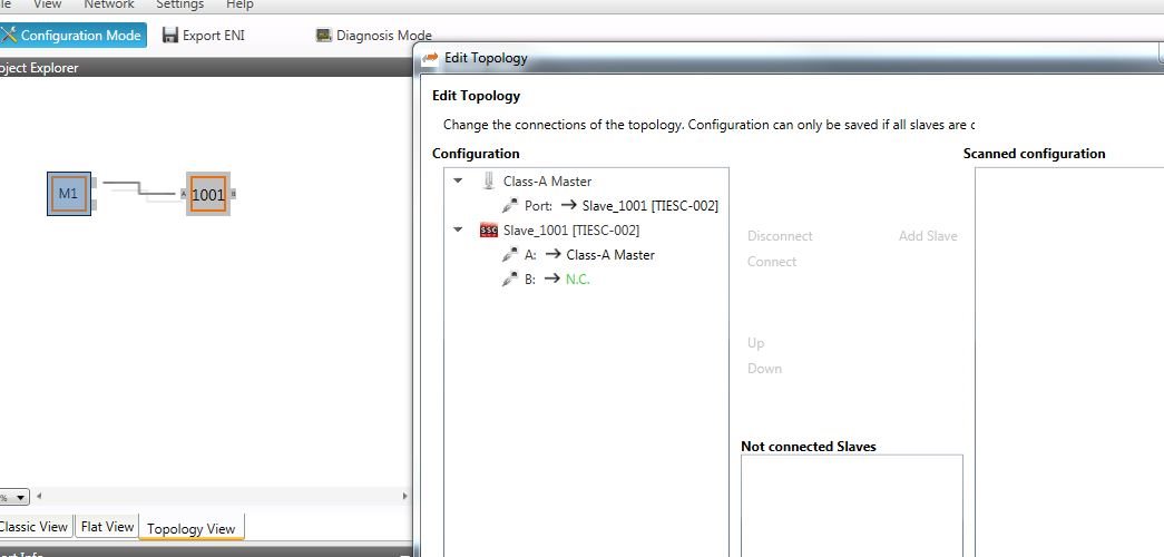

  • HI Paula & Vladimir,
    Thanks for the help so far.
    Currently, when I see the topology information, I understand it is not a RING still.
    Port B of the slave is not connected back to the master. Please find the image below:
    Kindly tell me how can I configure the topology to be RING.
    To test the toplogy, I didnt connect the ethercat cable to the port A of the slave from the master's ETH0. But the Port B of the save is connected back to the Master ETH1. So , since there is a failure in the connection from master ETH0-Slave Port A, i was expecting the communication from  master ETH1 -> portB of slave.
  • Rohit,
    For cable redundancy you should not configure ring in EC-Engineer. You just configure 1 Master with slaves and disable LRW.
    Disable LRW is done in Advance Options -> Process Data Mode-> Disable LRW.
    You will not see RING in EC-Engineer.
    You should not use Port B during configuration.
    Redundancy is done automatically.
        Vladimir
