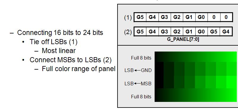

  • Hi Jeff,
    I still have one more problem to connect the display, I just found out that :
    the pin R_LCD_R0 is connected to the R_LCD_R5 pin and,
    the pin R_LCD_B0 is connected to the R_LCD_B5 pin. Why are they connected ? And should I just use for example the pins R_LCD_R0 to R_LCD_R4 ?
  • This device outputs in RGB565 format, and the panel is RGB666. This means we are lacking one red and one blue bit to output to the panel.
    See the below graphic, which shows 2 different approaches, in the case of attaching 6-bit output to 8-bit input.
    Tying off the lower bits gives the most linear color range, but you lose the full color range of the panel.
    The standard way is connecting the MSB outputs to the missing LSBs of the panel, which is what we did on the EVM.
