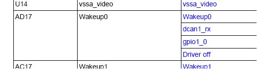

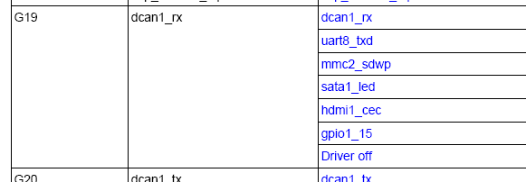

  • Hi Michel,
    U-boot selects dcan1_rx to be on ball wakeup0, set to mux mode=1:
    There is other dedicated ball (mux mode = 0) for dcan1_rx:
    EVM has dcan1 RX on the second option. You should change .dtsi file to match the second option. Refer to Data Manual and pad conf registers in TRM for details.
