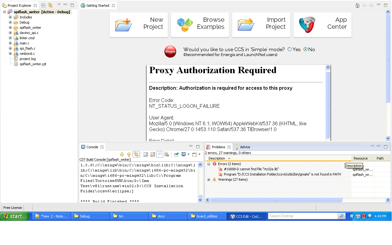

    As trying to build the flash writer  using ccs
    Use the following steps to build an SPI Flash writer using CCStudio v3.3:
    1) Run CCStudio v3.3.
    2) From the menus, choose Project->Open.
    3) Browse to the REL_LSP_02_20_#_#/PSP_02_20_#_#/
    board_utilities/flash_writers/spiflash_writer/ccsv3.3 directory, and
    open the spiflash_writer.pjt project.
    4) From the menus, choose Project->Build. The spiflash_writer.out
    build image is placed in the spiflash_writer/ccsv3.3/Debug directory
    When I try to execute the 4th step mentioned I am getting this error
    Kindly let me know what is causing this and how to add the file if its not present.
    I have not modified anything I have just taken the code and tried building it
    Attached image for reference
    Thank you

    CCS IDE seems to be not a CCSv3.3 but latest one.
    I think, you are using the latest CGT (code generation tools) which may not support the older CCS writers, can you please try to use the CGT version 7.4.4
    Let me try to reproduce the issue using the latest CGT.

  • Seems you are using the old flash utils.
    Can you please use the latest one ?
    Download the OMAPL137 flash and boot utils.
    sourceforge.net/.../
    Once installed, you can import the below location to get the SPI writer into CCS.
    C:\ti\OMAP-L137_FlashAndBootUtils_2_40\OMAP-L137\CCS\SPIWriter
    I'm able to build this writer project in latest CCS.
    Please let me know if any issues.
