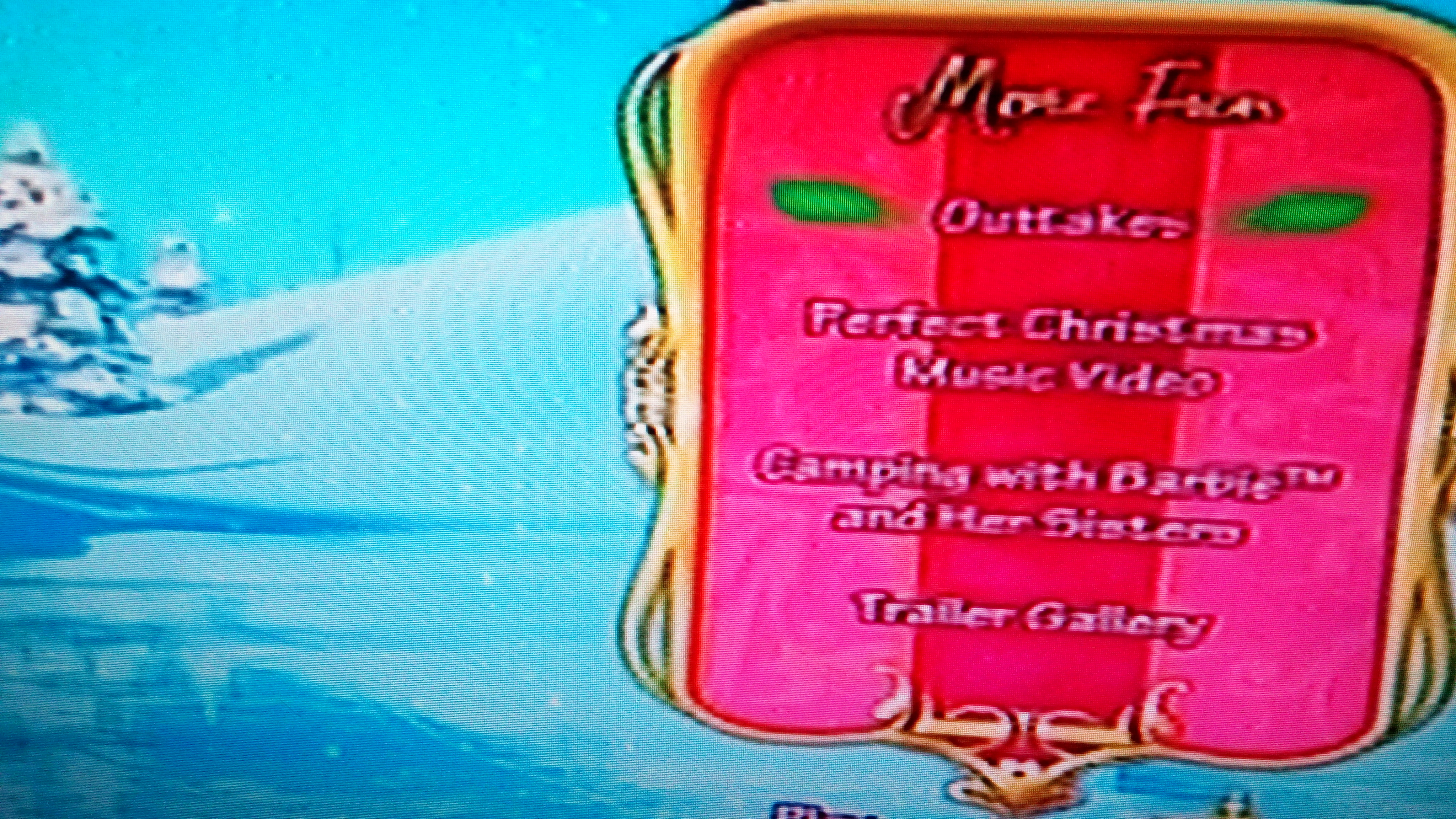

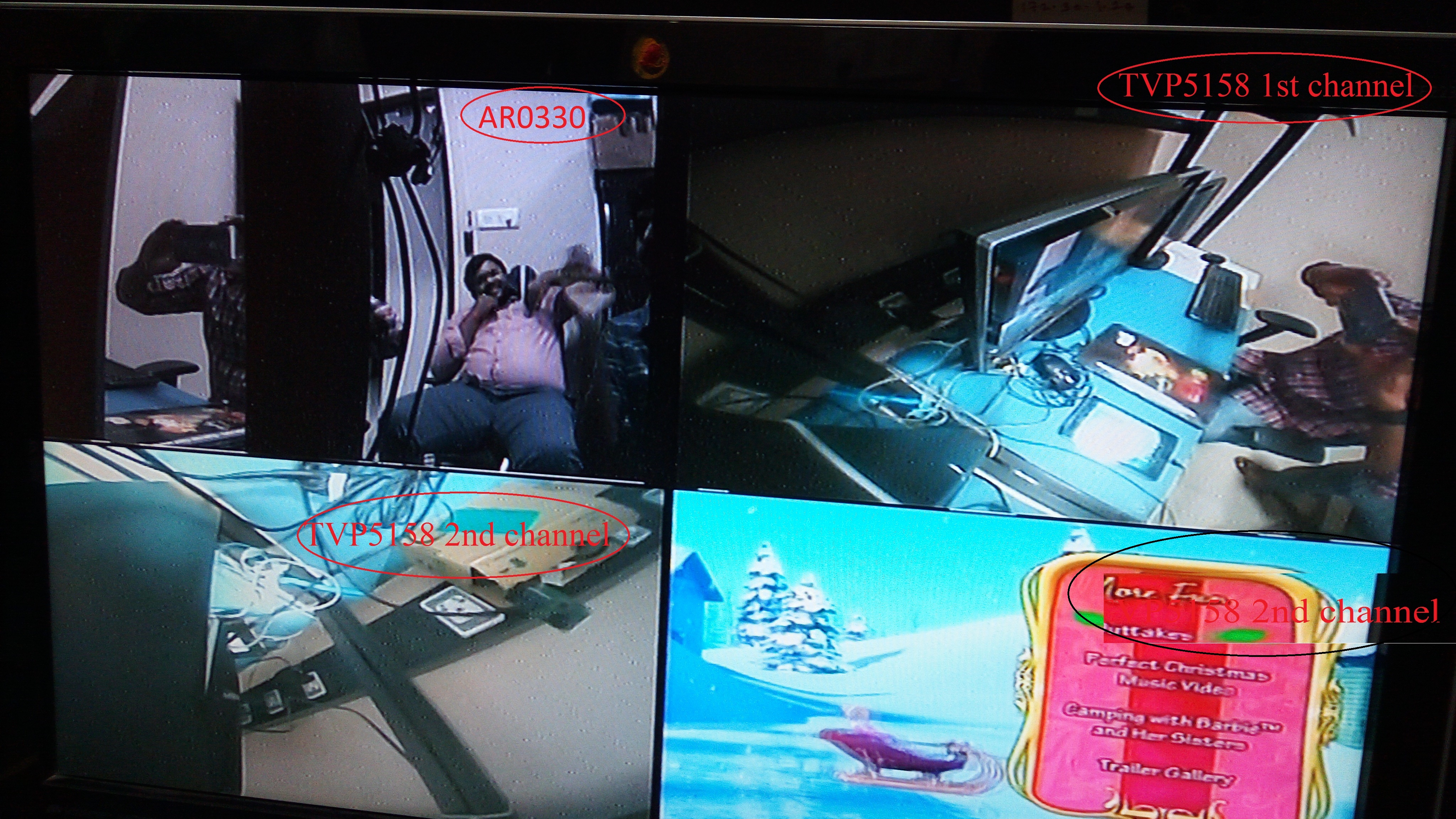

Hi All,
We are using DM385 custom board with IPNC_RDK 3.5.
We have four camera.(AR0330 + TVP5158 3CH(1ch we are skipping)).
My usecase_1 flow
camera(1080x1920 @30fps)  - > display scalar(720x480) - >
- > merge  - > swms - > Display
     capture (D1 3CH) - > NF - >
My usecase_2 flow
     capture (D1 3CH) -> DEI - > NF - >
Both the usecase we got same tvp5158 output(seems image not de-interlaced).?
Below i attached my usecase_1 and usecase_2.
