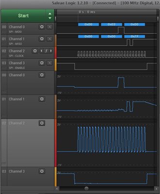

I'm trying to get spi working on a 5728, but when I try a transaction, the chip select drops low (active) for a short period of time and then goes high with no clock pulses at all.
If I use spi->SYST to bit bang the bits out, individually setting bits and pausing with wait statements, it works fine.
My initialization code looks like this:
spi->SYSCONF = 0x30a; // clocks maintained; ignore idle mode request; turn off wakeup mode; reset spi
while (spi->SYSSTAUS & 0x1 != 1);
// clk div pwr of 2; no fifo; cs 3.5 cycle buffer; xmit (mosi) on d0 and not d1; xfer 8 bits; 1.5MHz clk; cpha=1 dat chg on rise clked on fall
spi->CSREG[1].CHxCONF = 0x060603d5;
spi->SYSCONF = 0x308; // clocks maintained; ignore idle mode request; turn off wakeup mode; don't reset spi this time
spi->HL_SYSCONFIG = 0x4; // no idle mode; sensitive to emulation suspend; don't reset
spi->MODULCTRL = 0x1; // single channel master
