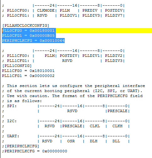

How to caculate the PLLandConfig settings in the ini file for -E chips?
Other Parts Discussed in Thread: OMAPL138
   I use the attateched sample_ini.ini file to make the ais file of a simple application and successfully do secure boot from nandflash.
   But I didn't understand how to caculate the PLLandConfig settings in the ini file.
   As in the configuration in sample_ini.ini file:
   Q1: How to caclulate the UART baudrate?
   Since the crystal is 24MHz, I caculated the sysclks as shown in the following table.

According to the C6748 Technical Reference, "The ASYNC3 modules use PLL0_SYSCLK2 by default, but all these modules can be configured as a group to use
PLL1_SYSCLK2 by programming the ASYNC3_CLKSRC bit in the chip configuration 3 register (CFGCHIP3) of the system
configuration (SYSCFG) module."
I didn't find any setting of ASYNC3_CLKSRC in the sample_ini.ini file. But I think here, UART Input Clock=PLL1_SYSCLK2.
Since OSR=0x01, DLH=0x00, DLL=0x64
So, UART BaudRate=144MHz/13/100=110,769Hz  ,  which is quite far from 115,200Hz.
What's wrong with my caculation?
Thank you.https://e2e.ti.com/cfs-file/__key/communityserver-discussions-components-files/791/8637.sample_5F00_ini.ini
Frank
  • As given in comment, PLL0 control register divided into two section "PLL0CFG0" and "PLL0CFG0"
    ; |------24|------16|-------8|-------0|
    ; PLL0CFG0: | CLKMODE| PLLM | PREDIV | POSTDIV|
    ; PLL0CFG1: | RSVD | PLLDIV1| PLLDIV3| PLLDIV7|
    [PLLANDCLOCKCONFIG]
    PLL0CFG0 = 0x00180001
    PLL0CFG1 = 0x00000B05
    PERIPHCLKCFG = 0x00010064
    PLL POSTDIV = 0x1
    PLL Multiplier = 0x18 (24)
    CLKMODE = 0x1 ( 0 -> Internal oscillator and 1 -> Square wave)
    PLL Divider 7 (SYSCLK7) = 0x5
    PLL Divider 3 (SYSCLK3) = 0xB
    PLL Divider 1 (SYSCLK1) = 0x0 (Default 1)
    If CLK input is 24MHz, then as per these PLL0 values, OMAPL138 is running at 300MHz clock.
    (24 * (24+1) ) / (1+1) = 300MHz
    By default, ASYNC3 domain used PLL0_SYSCLK2.
    UART2 module clock would be 150MHz.
    150MHz/13*100) = 115384 (if divisor is 100 and 13x over sampling mode)
